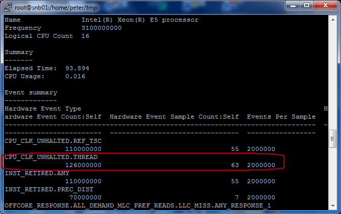

I am using vtune_amplifier_xe_2013 at a remote machine over a command line interface. In order to analyze the data in gui , I move the results to my local machine.
However, on openning the results in gui on a local machine, the hardware event counters are different than the counters in the summary of the cl report(conters like CPU_CLK_UNHALTED.THREAD, etc). This number is significantly different if I use __itt_pause() and __itt_resume() in my code to measure performance only of certain code sections.

1. amplxe-cl -report summary -r r00?ah, at remote machine
2. amplxe-gui to open result copied from remote machine, but CPU_CLK_UNHALTED.THREAD event count in summary report is different from 1) ??
Incredible! Can you please post your zipped result directory on this thread?

Yup, thats the case. The Hardware events counter on UI are much different than the one on summary.  Please find the results attached.

Thanks for result directory. I got same result by using VTune GUI and command line. (VTune Amplifier XE 2013 Update 13)
