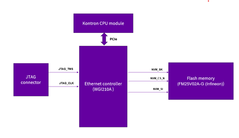

I'm using WGI210A Ethernet controller, which is connected to Kontron CPU module through PCIe.
  • The JTAG connector is mapped to the pins JTAG_TMS, JTAG_CLK, and JTAG_TDI of the Ethernet controller.
  • The flash memory FM25V02A-G (Infineon) is connected to pins NVM_SK, NVM_CS_N, and NVM_SI of the Ethernet controller, which correspond to pins WP_N, CS_N, and HOLD_N of the flash memory.
Query is MAC Address is not configured (00:00:00:00:00:00). To configure the MAC address
  • What tool needs to be used to program Flash memory?
  • What file needs to be programmed into the flash?
  • Can it be programmed through JTAG, or does any other physical device need to be connected?
  • What physical hardware to be used to program?
  • In document 513655, there are many files. Which file needs to be used in iNVM?
Can you please help me out?

I have some experience with eeupdate, from your post it looks like it needs to have a MAC address configured.
Before following these steps locate the MAC address on the network adapter and write it down
Here are the steps to perform the MAC Update:
1. Locate the eeupdate binary for your OS.
2. Make sure the driver is installed, there should be one in the preferred OS directory.
3. Once the driver is installed open a terminal or command prompt.
4. For this example I am using linux, but if using windows it will be similar:
 From the eeupdate directory in the CLI type the following to locate the adapter: sudo ./eeupdate64 and hit enter
 this should list the adapters installed in your system
5. Example if you need to update nic 1: sudo ./eeupdate64 /nic=1 /MAC=macaddress
6. Hit enter
7. To be safe, reboot your system after adding the mac address.
8. To verify the MAC address was programmed type: sudo ./eeupdate /nic=1 /ADAPTERINFO
That will return the adapter info, and you should now see your configured MAC address.
P.S. If this is a multiport adapter you will need to assign a MAC to each port.
