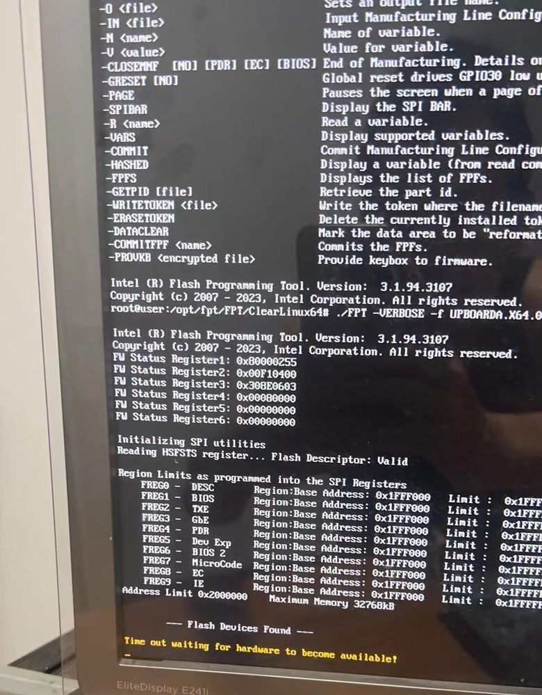

When I use FPT tool to update flash on E3900 system(ApolloLake) on Ubuntu 18.04with kernel version 5.4.0-42 ,  It fails with hit " Time out waiting hardware to become available" error message.  Please refer following screen shot. And also I dump TxTInfo as below as well.
Please help to check source code what is meaning of this error message.

--------------------------------------------------FPT under Linux --------------------------

Hello @Yingwen001 ,
The Embedded Apollo lake CPU has just reached the End Of Interactive Support; that being said I would suggest using FPT under UEFI or Windows environment, if that still fails you might want to reach your BIOS vendor and ask for a proprietary BIOS flashing tool.
