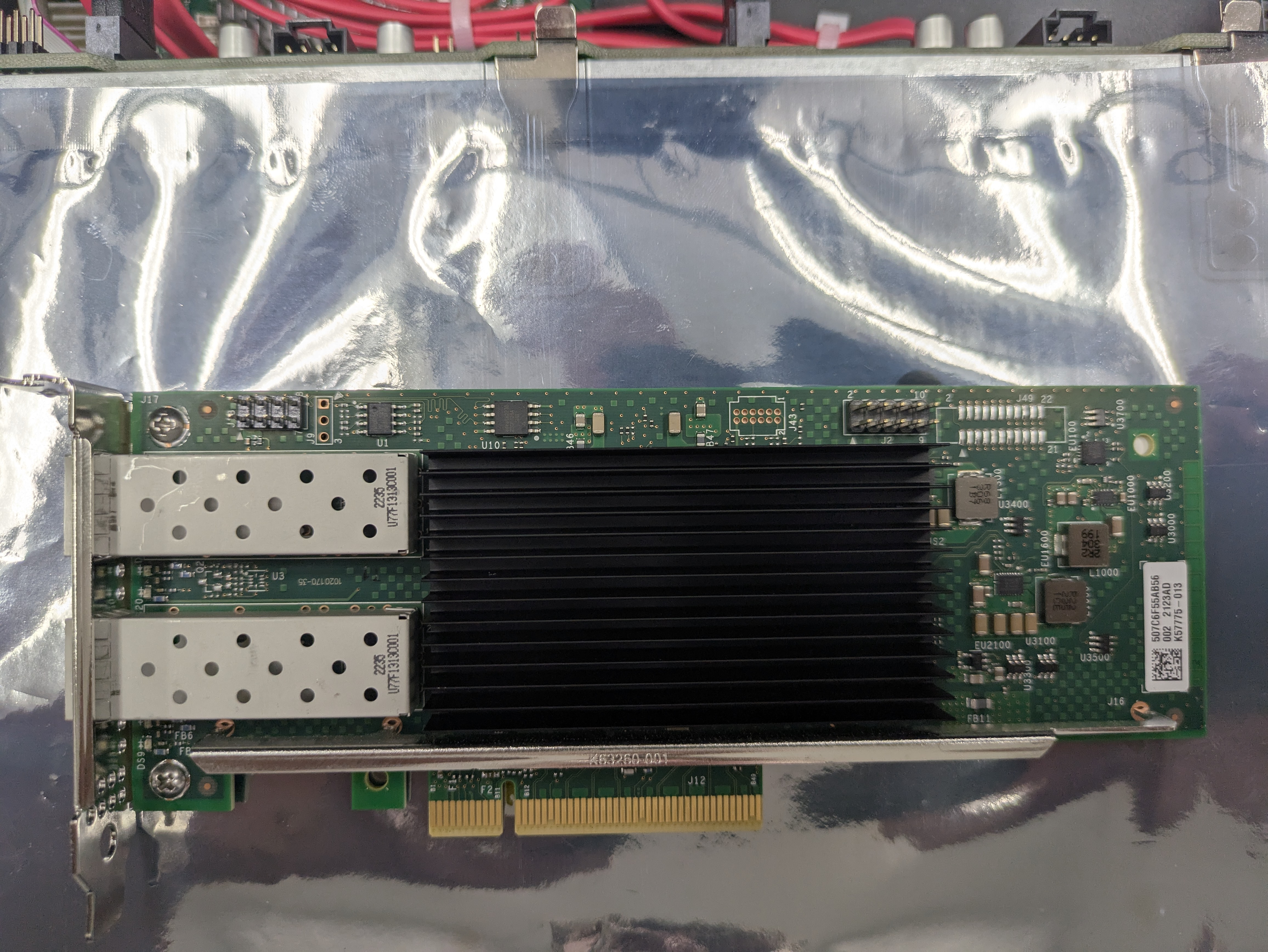

Pictures attached.
SSU logs attached.

Hi latency_hunter,
Thank you for your response.
Would you be able to share with us the NIC card with the label to check the marking?
Along with that, please let us know if you are using the latest driver and firmware as the below link:
Regrads,
Fikri O.
