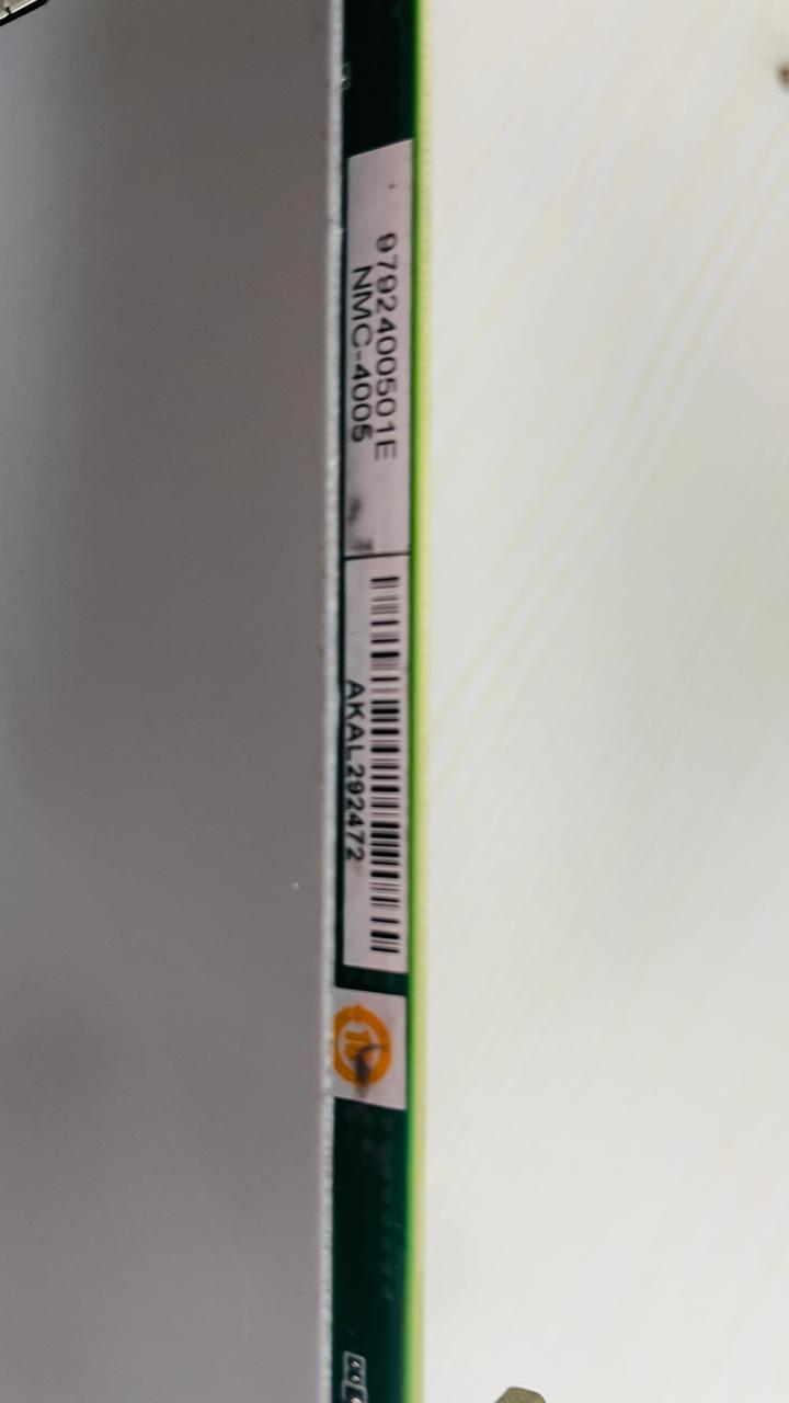

1. System/board details:
2. Complete ethernet card details:
3. Please share front and back pictures of the network card with the serial number clearly visible.
Your prompt response with this information will greatly assist us in diagnosing and resolving the issue as quickly as possible.

Hi Simon,
The details you requested in the previous thread are mentioned below. Please review them and assist us in enabling RX-FCS on the ens5f0 interface.
Here, we are using Versa 1000 FWA-5020U-00A1R server and NMC 4005 (x710 based) slot.

2. Complete Ethernet Card Details:

3. Please share front and back pictures of the network card with the serial number clearly visible. -- Snaps are attached.
Hi Ashok_raja,
Good Day!
Thank you for sharing the pictures of the adapter. Unfortunately, after reviewing the pictures it seem that this card is an OEM(Original Equipment Manufacturer) and therefore kindly request you to contact OEM for any further assistance required regarding this adapter.
Please don't hesitate to ask any further questions in the future. Feel free to start a new conversation, as this thread will no longer be monitored.
