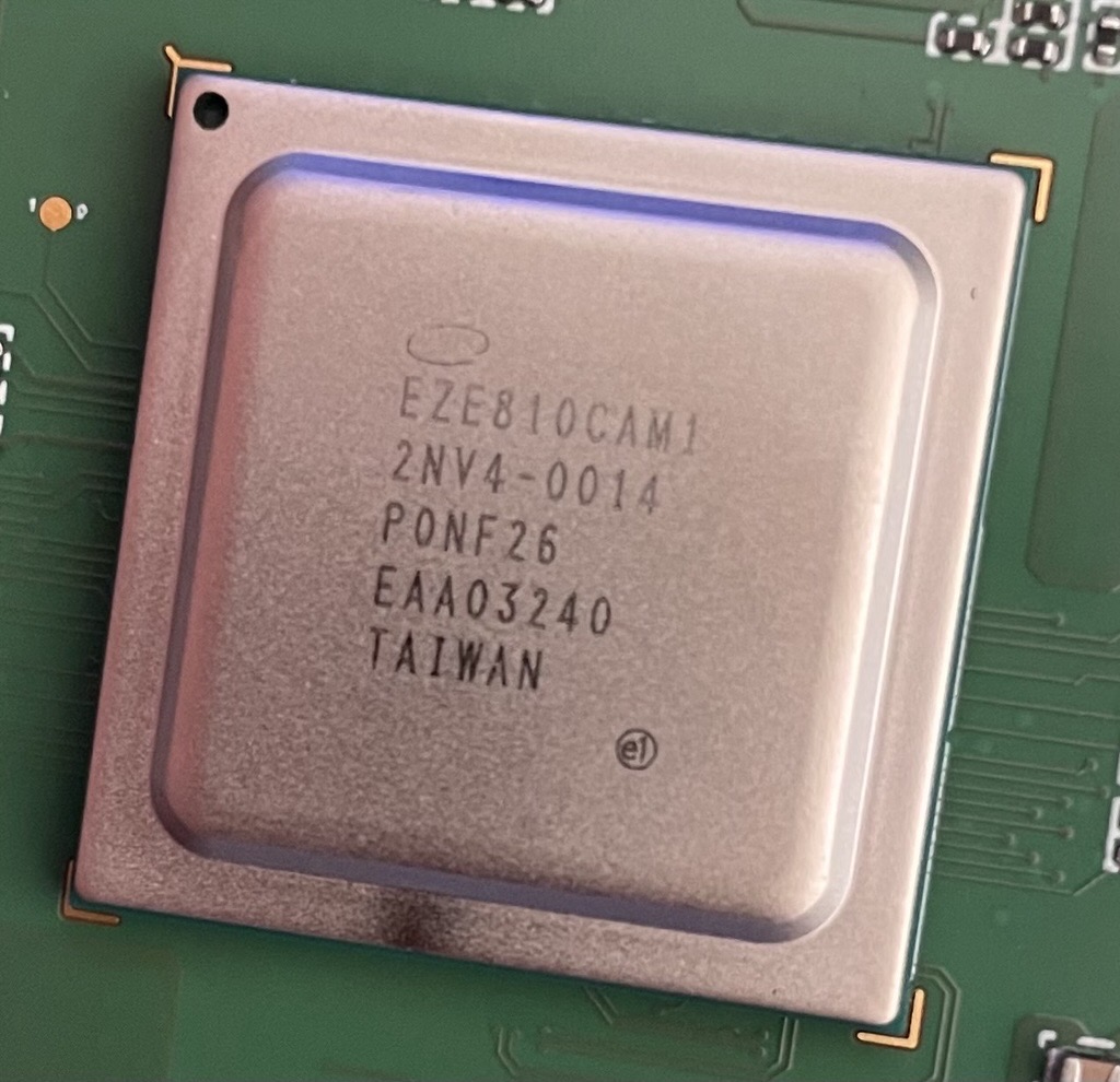

I've got an issue configuring Intel E810-CAM1 via nvm image.
The ethernet controller should provide 4 x 10G SFP+.
I couldn't figure out the right tool to execute the initial programming of the blank flash.
As far as I know, eeupdate64e and lanconf64e are not supported by 800 Series Controllers, while nvmupdate64e is used for updates of already programmed nvms.
I'm also searching for the right nvm image for a 4 x 10G SFP+ application.
The chip sits on a self developed NIC-Board, containing Intel E810-CAM1 Controller, blank qspi flash, an sfp+ cage and needed peripherals (power sourcing etc.). The system is running on linux, an Intel XEON serves as host. Please let me know if you need any more information.
Can you help me out with the right tool and nvm image?
Best regards
Christoph
