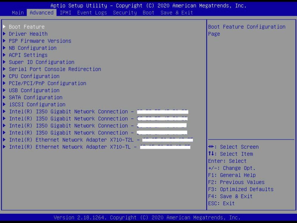

I recently bought an Intel X710-T2L card from Provantage, I see that in the UEFI/Bios of my SuperMicro system, Windows 10 and even Linux (tried Ubuntu) one port reports as an X710-T2L and the other reports as a X710-TL. Is this normal?

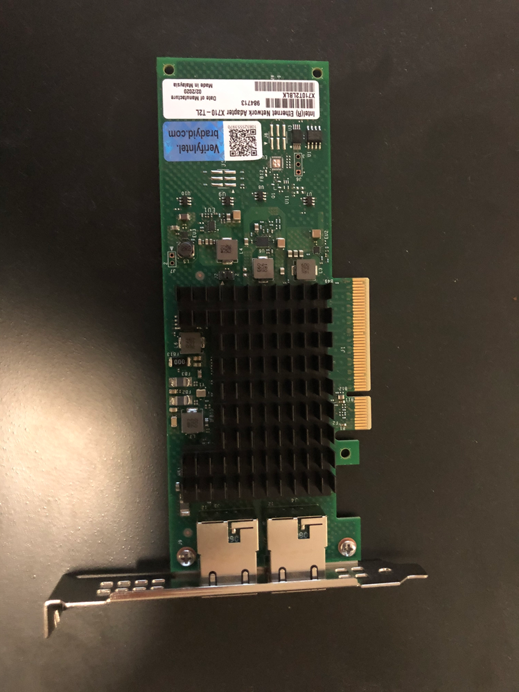

Thank you for the update. I will wait for your screenshot. If you can also provide the picture of the X710-T2L focusing on the markings on both sides for me to validate is also. That would be helpful in our investigation.

I actually managed to get it now as I could afford some down time. As you can see from the Bios/UEFI image the first four ports are from the onboard Intel i350 Gigabit controller. The last two ports are from the Intel X710-T2L card, as peviously mentioned. Also I updated from the 7.21 to 7.30 firmware and still the issue exists.

Here is a screenshot after running pciconf -lv in my pfSense firewall. You can see below the 4x Intel i350 ports have the same identifier as one would expect. However with the Intel X710 T2L card there's a difference in identifiers between its two ports.Screen Shot 2020-06-12 at 1.14.04 PM.png

Upon further checking, I am sorry to say that there is no workaround and no fix for this issue. We really apologize for this. Please check our explanation below:
Implication: No functional impact to the device or drivers. However, this might impact the branding of the device if the Subsystem ID is used to select the device branding string.
Workaround: None. Status: B0=Yes, B1=Yes; No Fix
