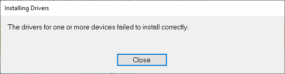

Thank you for the quick reply!
It would appear that I already have the latest driver installed (4.1.254.0).
It looks like the problem is with the Intel Driver & Support Assistant program, which is the program notifying me of the update.
When the Intel Driver & Support Assistant program attempts to install driver version 4.1.264.0, that's when it fails.
I believe this may be a bug in the Intel Driver & Support Assistant program.

Hello THX,
Greetings!
Thank you for the feedback, please let us know what version of Windows 10 are you using?
Besides that, download and run Intel DSA Uninstaller (https://www.intel.com/content/www/us/en/download/19333/intel-driver-support-assistant-uninstaller.html?v=t) first. This will remove all remains of the previous installation. Next, try to install Intel DSA again (https://www.intel.com/content/www/us/en/support/detect.html)

DSA successfully uninstalled...
DSA successfully reinstalled...
Same error/issue as before...

Yes, I have tried the manual installation method and it says the best drivers for your device are already installed.

Yes, to both questions.
The driver failed to install both before the firmware upgrade and after the firmware upgrade.
I believe this is a bug in the DSA tool and/or the Intel drivers itself.
