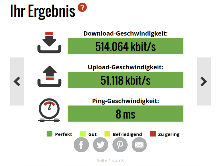

- post removed because the slow network speed turned out to be caused by the switch, not the nic -
See attached screenshot. This is what I get with the "Intel EXPI9301CT PRO/1000 CT Desktop Gigabit PCI-e (82574L)" after changing the switch.
