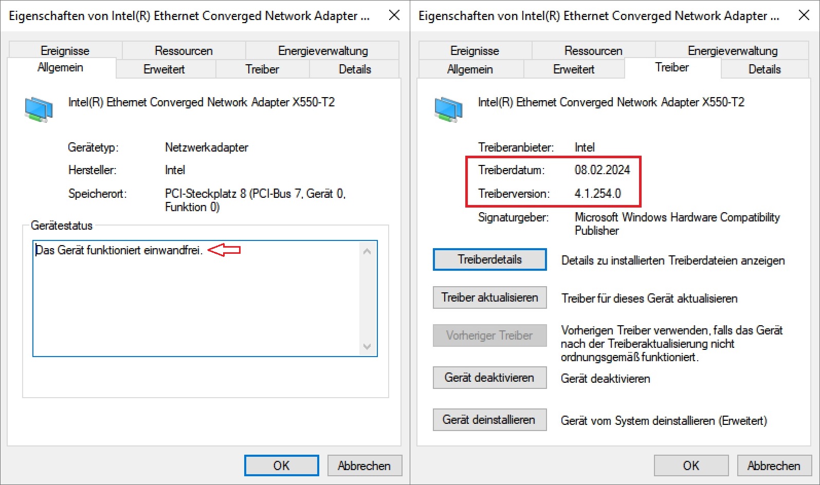

The problem persists. Even with the current driver packet version 30.5, only driver 4.1.254.0 works. Driver 4.1.267.0 fails. NVM firmware update 3.70 doesn't change anything either. I also bought an original genuine X550-T2. Intel should finally fix this bug. After all, it's been around for two years now.

Thanks for the good news. Didn´t expect you still watching this thread and i´m very happy to see you back here. I´m still using Windows 10 x64 - 21H2 build 19044 which shall still be supported as the readme from driver package 30.5 tells but maybe they are not testing the compatibility with Windows 10 anymore. I will download the Windows 11 driver version and try if that is working for me too as they are very similar OS. I´m back here tomorrow and tell the result.
PC-Junkie
4,887 Views
Well i could try it right away and there is no difference. It still doesn´t work. So i will make a test tomorrow with a fresh Windows 11 installment and report back. Maybe there is a difference between both OS. I have to find out. Which version of Windows 11 are you using?

With Windows 11, the latest drivers were finally installed correctly on my system and are working perfectly. This means that Windows 10 is no longer supported starting with package version 30.5, even though the latest drivers are still dated September 2025 and Windows 10 support only officially ended in October (which, incidentally, doesn't yet apply to the IoT Enterprise LTSC 2021, which is supported until 2031). Furthermore, the driver is officially listed as supported by Intel for Windows 10 21H2 Build 19044 in the 30.5 readme file. All of this is neither user-friendly nor reliable. Unfortunately, I guess we'll just have to live with it. I'm switching to Linux Mint anyway, as I don't like Windows 11 at all.
