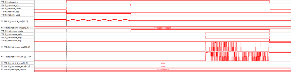

I have designed a system which takes the output of an on-chip ADC (MAX10) and performs an FFT on the data.
I am using a 1KHz test waveform and approx 4.5V.
I sample the output of the ADC every 598th tick of a 50MHz clock (83.6KHz sample rate)
I convert the 12-bit ADC data to 14-bit twos compliment by appending “00” to the front, as the signal is always positive anyway due to a DC offset.
This is then fed into the FFT core’s sink_real, whilst sink_imag is set to 0.
The FFT appears to be performing correctly with no errors, but my output looks incorrect:
sink_real format: signed line chart
source_real/imag format: unsigned line chart
The output is always almost either “11111111111111” or “00000000000000”. It is also different every time
setting the source_real/imag format to signed line chart looks like this
I’ve also attached a project archive.

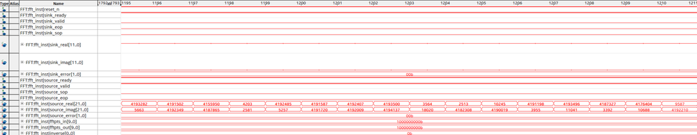

3,048 Views
Hi Chee
In that case, do you have any clue why my FFT might be outputting such strange values?
I've configure the FFT for fixed point representation, have given lots of extra bits to the output for bit grow (12 bits in, 22 bits out) and have no error flags with all ready/valid outputs working as expected.
But despite a reasonably clean sine input signal, my FFT outputs either near maximum or near minimum out put value seemingly at random (data in and out of the FFT displayed as unsigned line chart).stfull.PNG
The output of the FFT always looks different every time, but always just contains a seemingly random array of near min and near max values.
The input is a 1Khz sine wave sampled at approximately 83KHz
Any suggestions are very much appreciated.
