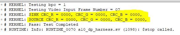

I am trying to simulate the Intel DisplayPort Arria 10 Sample Project(Quartus Prime v17.0) in Aldec Active-HDL (v10.3 64 bit) and don't think the simulation is working correctly.
The testbench executes all the way to the end with CRCs reported back to be all 0's for R, G & B. The vbid[3] - NoVideoStream_Flag is high during the entire simulation.
All of the signals mentioned in Figure 36 of UG-01131 (RX Video Waveform) are static for the entire simulation. I would expect the received video to look similar to the timing diagram of that figure.rx_waveform.JPGdp_rx_vid.JPG
Is there something wrong with the simulation or am I not setting it up correctly?

I used the User Guide's process to generate the example design and that is what I am trying to simulate.DP_GENERATE.jpg

The only simulator I have access to is Aldec Active-HDL. The displayport core has a debug CRC setting that can be enabled to confirm the data received into the core. The sample design enables it by default. The User Guide shows that the CRC shouldn’t be 0.

I run the simulation in modelsim_se edition and I also see the same observation (all zero). Let me check further on this.

I found that turn on Support CTS test automation in both Sink and Source will give a value to CRC. Tried this with modelsim and it is working now. # Testing bpc = 1 # Testing Video Input Frame Number = 04 # Testing Video Input Frame Number = 05 # Testing Video Input Frame Number = 06 # Testing Video Input Frame Number = 07 # Testing Video Input Frame Number = 08 # Testing Video Input Frame Number = 09 # Testing Video Input Frame Number = 0a # SINK CRC_R = 1015, CRC_G = 1015, CRC_B = 1015, # SOURCE CRC_R = 1015, CRC_G = 1015, CRC_B = 1015, # Testing Video Input Frame Number = 0b # Pass: Test Completed

I found the same: # KERNEL: Testing Link HBR2 Rate Training Pattern 3 # KERNEL: TX Frequency Change Detected, Measured Frequency = 135 MHz # KERNEL: RX Frequency Change Detected, Measured Frequency = 135 MHz # KERNEL: End Testing Link HBR2 Rate # KERNEL: Testing bpc = 1 # KERNEL: Testing Video Input Frame Number = 07 # KERNEL: Testing Video Input Frame Number = 08 # KERNEL: Testing Video Input Frame Number = 09 # KERNEL: Testing Video Input Frame Number = 0a # KERNEL: Testing Video Input Frame Number = 0b # KERNEL: Testing Video Input Frame Number = 0c # KERNEL: SINK CRC_R = 9b40, CRC_G = 9b40, CRC_B = 9b40, # KERNEL: SOURCE CRC_R = 9b40, CRC_G = 9b40, CRC_B = 9b40, # KERNEL: Testing Video Input Frame Number = 0d # KERNEL: Pass: Test Completed Thank you for the help!
