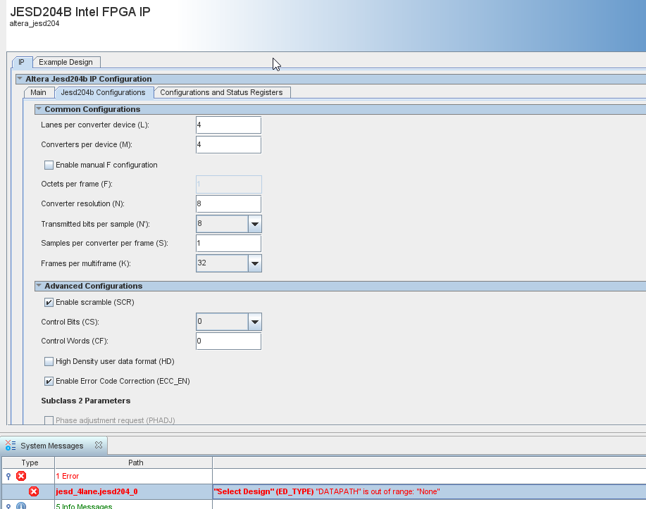

I am targeting an Arria 10 SX to receive data from a TI ADC09QJ800 (quad ADC).
The ADC device will link over 4 lanes and convert at either 9 or 8 bits.
I am trying to configure the JESD204B IP within the IP Editor (Quartus Prime Pro 22.4) but get
an error message:
"Select Design" (ED_TYPE) "DATAPATH" is out of range: "None"
See the attached screenshots.
Could someone help me decipher this somewhat cryptic message.

solved by deleting current IP variant and starting again from scratch.
