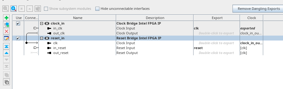

I have a query about how Platform Designer works with DSP Builder. For example:
I have an example design for DSP builder for FFT in Quartus itself. When I run DSP builder and Quartus simultaneously, no matter what, I can't get the .qsys file. However, I can get .tcl files.

I have found my answer. In Quartus Prime Pro 24.1, the platform designer itself doesn't create a .qsys file; we have to manually create it, which can be named as you desire, but better to give the name as .qsf or .qpf files.

I am playing around with this PD. I have some DSP builder models, i simulate it in Matlab/DSP Builder, then run the .qpf (Toplevel entity) file in Quartus. I go a lot of files. Then i created a .qsys file, and opened it in PD. It gives me clk_in and reset_in interfaces GUI.
How can i move forward after this? Adding IPs and so on or making a complete design.

Hi Sstrell,
