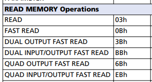

FHint
New Contributor II
1,665 Views
Hello Farabi,
the restrictions mentioned in the document you attached don't seem to interfere what I am trying to achieve.
  • I am using 4 Byte addressing
  • I am using 10 dummy cycles
  • The third party flash supports the four Opcodes mentioned in the document, as you can see her:
    and
Can you explain what else I can learn from chapter 2.3 of the document you attached?
As mentioned in the original post above, the correct data is transmitted by the Flash via SPI, but the GSFI doesn't output it via the Avalon-MM slave.
Florian
