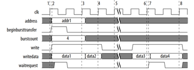

Write Bursts
This example demonstrates signal behavior during write operations in burst mode. Burst mode refers to a mode where data is sent continuously. By specifying an address and burst count (the number of consecutive data items to receive or send) at the beginning, you can receive or send burst count number of data items from the address location.
Image Source: Avalon® Interface Specifications Figure 14. Write Burst with constantBurstBehavior Set to False for Master and Slave
  1. address, beginbursttransfer, burstcount, write, and writedata are asserted by the Master. However, since the Slave asserts waitrequest, no data is sent from Slave to Master.
  2. The Slave asserts waitrequest, so it does not complete reception of writedata.
  3. Since the Slave deasserts waitrequest, it receives data 1.
  4. Since the Slave deasserts waitrequest, it receives data 2.
  5. The Master deasserts write, so the Slave does not receive writedata.
  6. Since the Slave deasserts waitrequest, it receives data 3.
  7. The Slave asserts waitrequest, so it does not receive writedata.
  8. Since the Slave deasserts waitrequest, it receives data 4.
