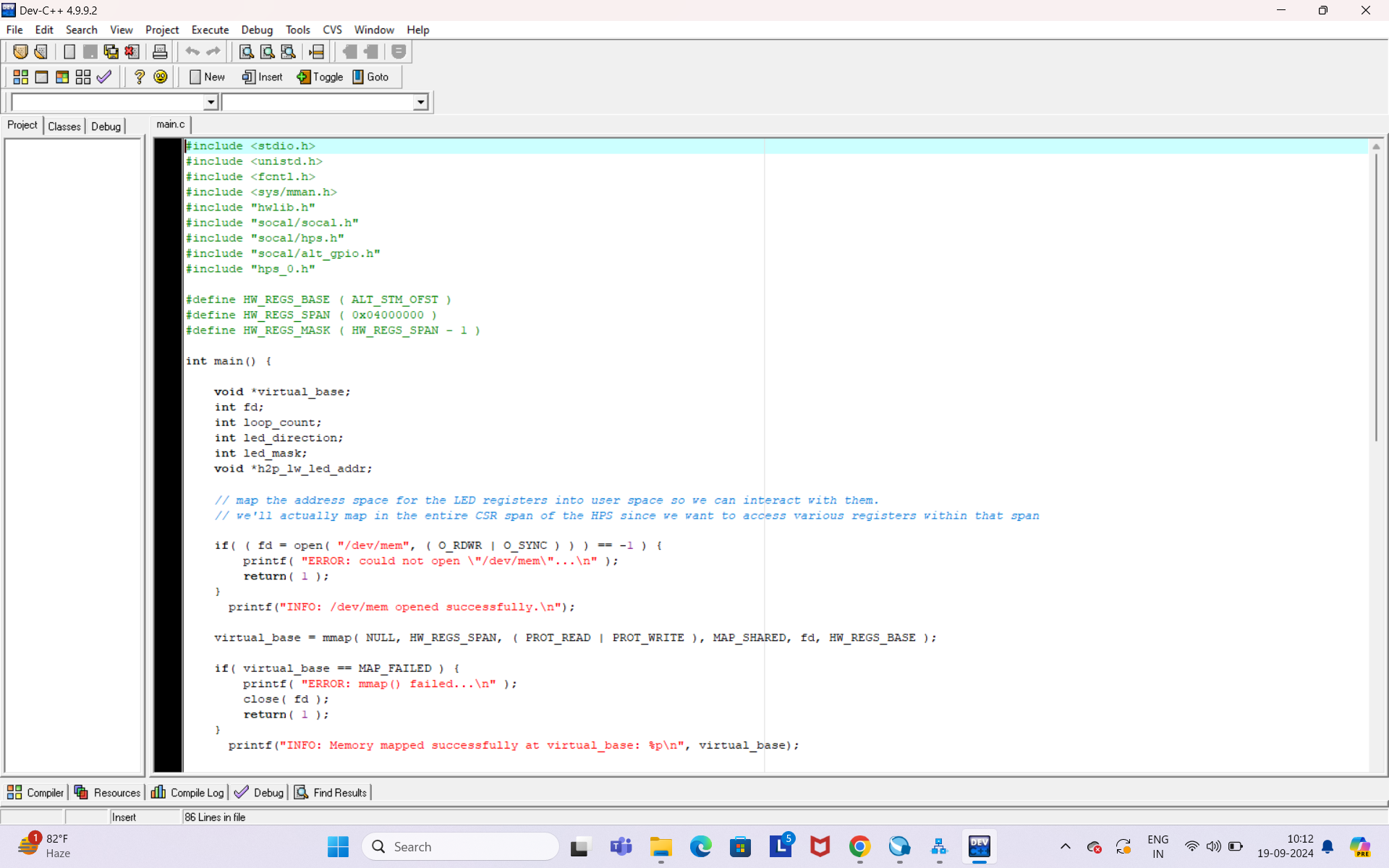

I need to control 7 gpio pins for output and 8 gpio pins for bidirectional. when I tried to change the pre-existing qsys file from my_first_hps-fpga, it did not work.
I only tried to change the PIO width and added another PIO component on that, there was no error, and compilation was fine, but when I sent the embedded C program on board and tried to run it did not work. I put printf statement after every operation, I found out dev\mem opened only, after that program do not work.
I am not able to find out what the problem is, I tried everything, and I feel I will be stuck here forever, please help me with this, at this point it is frustrating.

Thank you for the reply. I have attached the qsys file, PIO LED setting, and HPS configuration along with the embedded C program too.
Target device is De1-Soc.

FPGA GPIO , but trying to control through HPS through AXI
