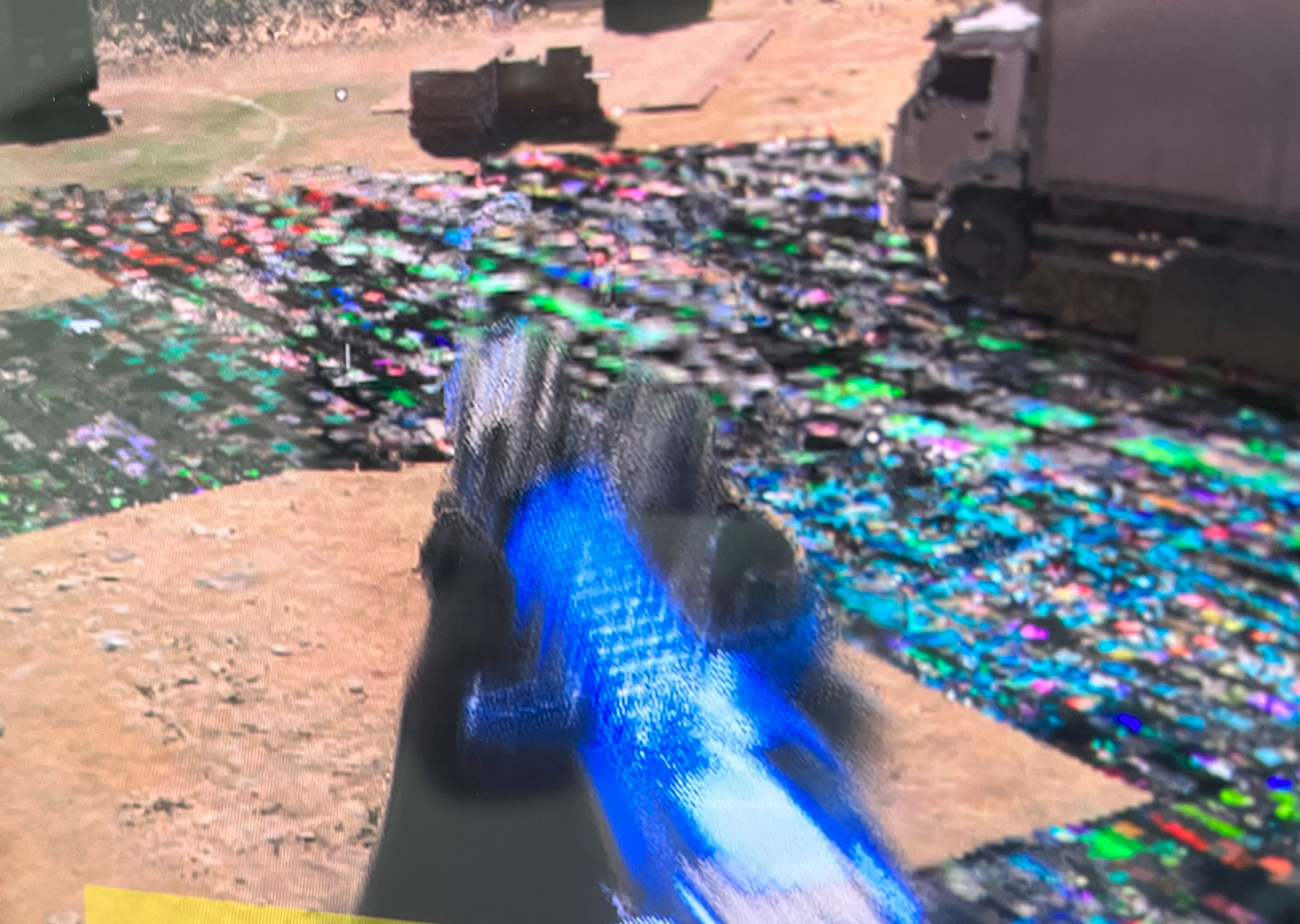

I have not checked for a while, but now I installed the latest drivers for Intel Iris Xe (31.0.101.4644) and surely, the ground (for example) is still heavily glitched in Call of Duty: Warzone 2.0 with "colored carpet patterns" appearing (and disappearing) in a very distracting manner and it still renders the game very unenjoyable.
It's kind of depressing that the issue has been there since the release of the game in Nov 2022 and it was reported back then and it still persists. Otherwise the game runs just fine with modest graphical settings, achieving a steady 45 fps.
There have probably been dozens of bugs / issues / glitches fixed during the last year and thank you for the support team for that. This msg is just a heads up that it still is bothering and I'm looking forward for it being eventually taken care of.
I attached some pictures from a game to demonstrate the issue (taken with a phone).

I created the SSU-report, see the attachment. In short, I'm using ASUS Zenbook 14X OLED with Intel Core i7-1165G7, 16 Gb of RAM, Intel Iris Xe iGPU. Windows 11 Home with all the updates.
Regarding the minimum system requirements, the system does not meet them since the game states GPU "NVIDIA® GeForce® GTX 960 or Radeon™ RX 470 - DirectX 12.0 compatible system", and I'm specifically (of course) playing on Intel Iris Xe --- but since it is a DirectX 12 compatible GPU it should not matter.
And about the Report for Intel Graphics Command Center... the newest drivers include Intel Arc Control to adjust the settings of the GPU, NOT the Intel Graphics Command Center... and it seems there are no option to generate a report, like in IGCC. That's why it's not included.
The only reasonable explanation is that the drivers for Iris Xe are doing something wrong when drawing the terrain..?

The procedure to get the debug logs turned out to be a bit more hassle than I thought for the following reasons:
1) I did not have Dbgview.exe readily installed on my computer, so I used the one I found from Mircosoft at https://learn.microsoft.com/en-us/sysinternals/downloads/debugview
2) The game seems to crash constantly if I set the game executable (cod.exe) to be inspected by dxcpl, so I can only enter the game mode selection screen and I do not reach the actual glitched in-game graphics. I included a log (Debug_29Aug2023_4.LOG) that shows the errors that get spammed just before the game crashes.
3) I was able to set the game executable (cod.exe) to be inspected _while_ I was playing the game, and I included here also a log of that. It seems to contain much less information, so it might not give much extra information, see Debug_29Aug2023_6.LOG . Maybe the bugged graphics get generated at an earlier step?

We just received an update on this matter, since the requirements site does not mention IGPU, it is an unsupported product for the game.
However, you can check if the version 31.0.101.4826 works better. Intel cannot guarantee the performance since the system does not meet the minimum requirements.
Jose B.
