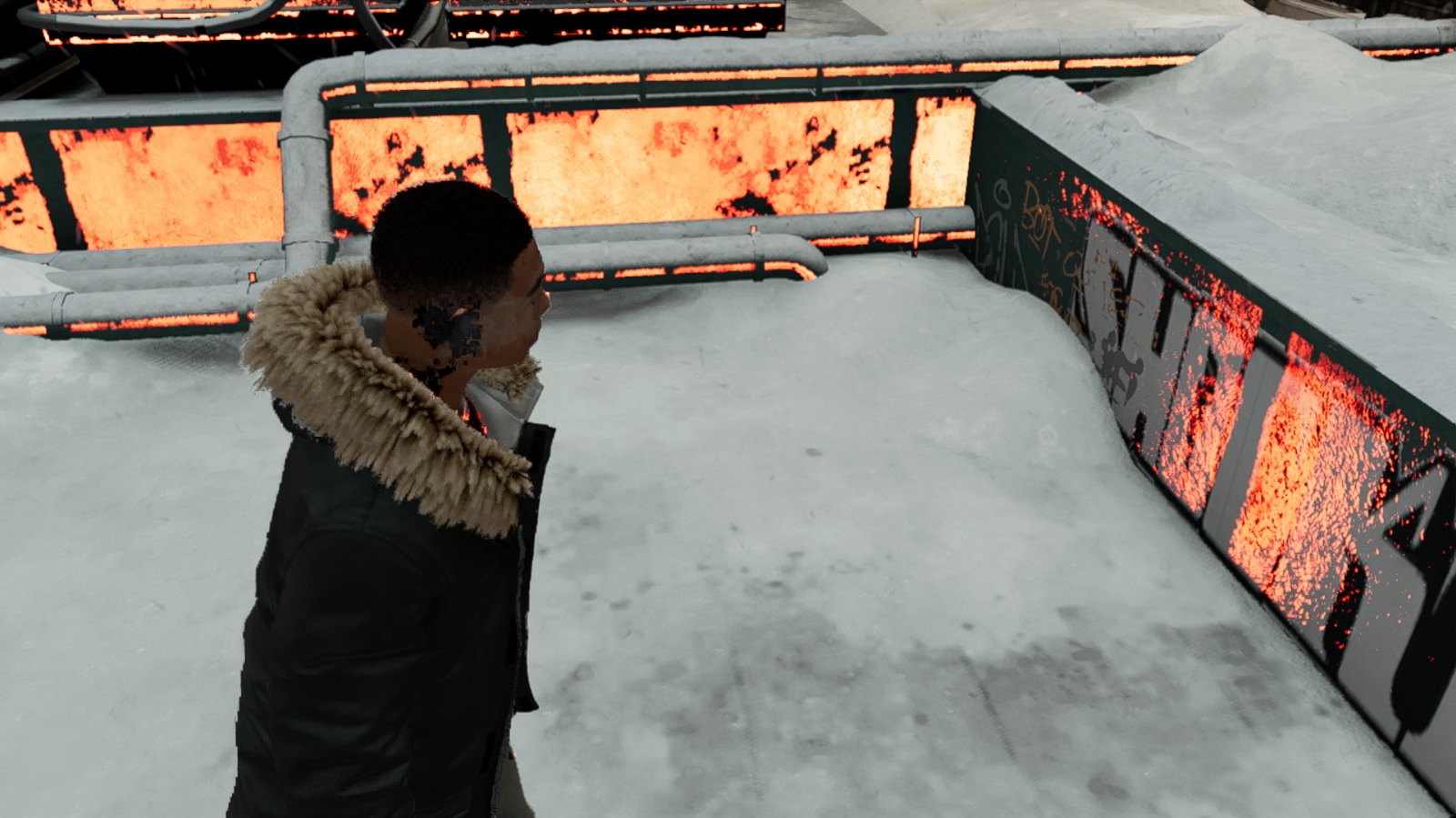

Hello Susumato7,
- What is the model of your Graphics controller?
- If you are using an Intel Arc Graphics, are you using an Intel brand Arc Graphics card?
- What is your game launcher?
Michael L.
Obrigado por responder, minha placa de vídeo é uma Intel iris xe graphcis, não sei qual seria o controle gráfico porque estou usando um tradutor para entender, já tentei mudar a qualidade da textura nas configurações do jogo, já mudei a resolução, já mudei a qualidade das sombras, já deixei tudo no mínimo e tudo no máximo, mas nada funciona, My launcher was pirated but thinking that the problem was that the game was not original, I bought it but it didn't change.
Hello Susumato7,
Thank you for the update.
For further investigation, kindly help provide the following details:
- Please help share videos of the issue.
- Can you try to download the game using the official distributor like Steam?
- Please help generate the SSU logs of your system, Please refer to the link below for the steps on how to generate the logs:
Michael L.
https://youtu.be/RSff1kOfwG8
the lag is because I'm recording, I bought the game on steam and it's still the same, I generated the SSU and what do I do with it?, sorry I really don't know what to do

Hello Susumato7,
Upon checking the SSU, I found out that the Graphics driver is not updated. You are using driver version 32.0.101.6078 and the latest driver is version 32.0.101.6732. You may download this in the link below:
https://www.intel.com/content/www/us/en/download/785597/intel-arc-iris-xe-graphics-windows.html
However, upon further checking. The game that you are playing requires a higher Graphics for it Minimum hardware requirement. Have you tried contacting the game developer if they support onboard Graphics?
https://store.steampowered.com/app/1817190/Marvels_SpiderMan_Miles_Morales/
