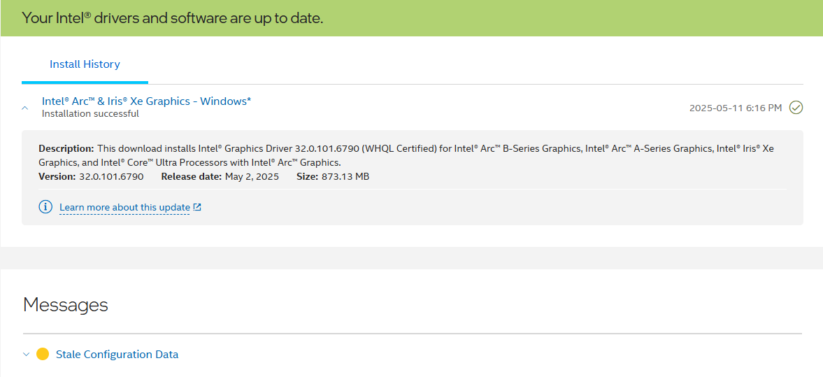

Carlo1961
1,227 Views
32.0.101.6790 figura installato il 2 maggio vedere immagine non va bene ieri ho installato 32.0.101.6795 !
RandyT_Intel
1,210 Views
Hi @Carlo1961,
The Intel Driver & Support Assistant (DSA) is a tool designed to help users keep their Intel drivers up to date. However, there are several reasons why it might report an older driver as installed and not recognize newer ones. Sometimes, the latest drivers may not be compatible with your specific hardware or system configuration. Intel DSA might report the most compatible driver version for your system, even if it's not the latest. If your computer is from an Original Equipment Manufacturer (OEM) like Dell, HP, or Lenovo, they might provide customized drivers for your hardware. These OEM drivers can be different from the generic drivers provided by Intel, and Intel DSA might prioritize these OEM versions over newer generic ones. Occasionally, Intel's servers might not have the latest driver information available, or there could be a network issue preventing DSA from accessing the latest data.
Let me know if you need more information.

Carlo1961
927 Views
32.0.101.6795 è installato lingua preferita Italiano, rimane da risolvere discrepanza Intel & Driver Support Assistant che dice installato un altro driver provo a contattare la sede Italiana di Intel!
