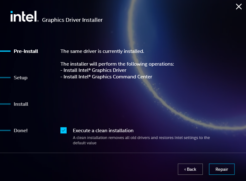

8. When I used the gfx_win_101.7080.exe installer to install the new driver, at some point there was an option that said: "Execute a clean installation" - "A clean installation removes all old drivers and restores Intel settings to the default value". And I enabled that option. You can see the option in the image here: https://esohelpportal.s3.us-east-1.amazonaws.com/All_Products/Intel/Intel_CleanInstall_EN.png
