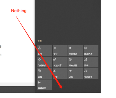

Thanks for your reply.
I checked on the official Microsoft website and this is normal
and like this
But my computer is like this
Following your advice, I removed the display device and uninstalled the original driver
Installed version 100.9864 and restarted the computer
This is the 101.1660 version
Plee11, You are very welcome, thank you very much for letting us know those results and providing the pictures.
We are sorry to hear the issue persists after installing the graphics driver. We will now do further research on this matter, as soon as I get any updates I will post all the details on this thread.
