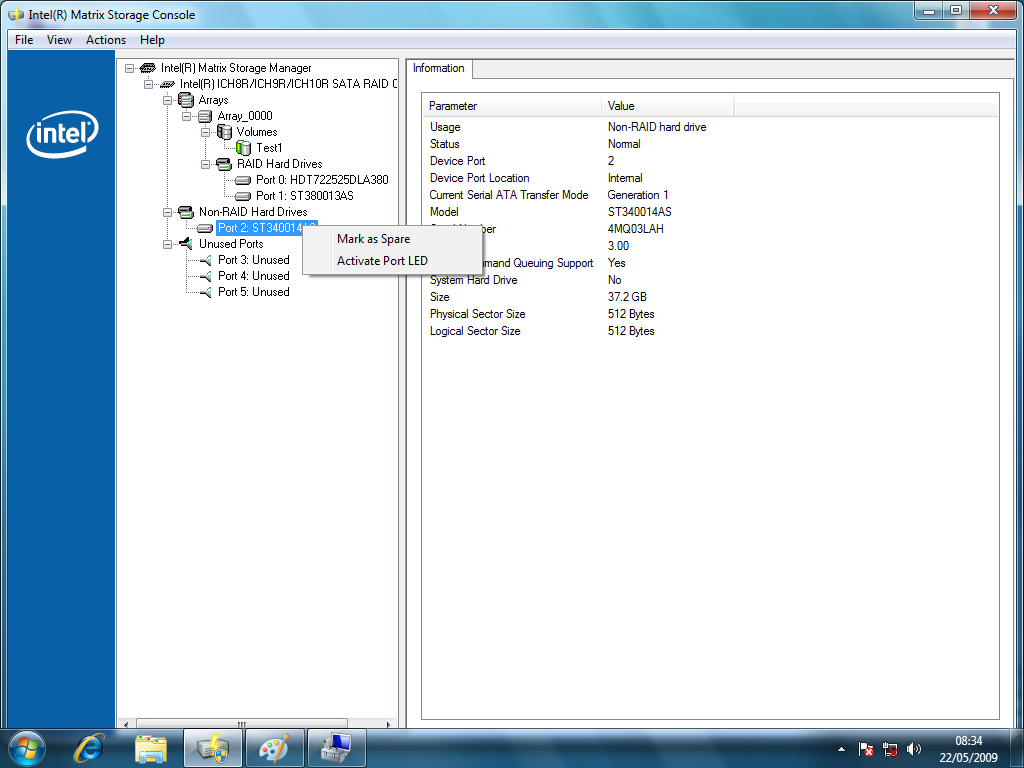

I'm using a DQ45EK motherboard with an intel dual-core E5200 (LGA775) processor. My issue is that when I go into the RAID menu to create the array I want (RAID5 array- 4 drives, 3 in the array, one as a hot spare). If I set up the array with 3 drives, it leaves the 4th out, not asking what to do with it, but it's bootable. If I use all 4 drives, the same thing happens, but it's not bootable.
My question is, how do I set up this 3 drive array to be bootable with the 4th disk being a hot spare?

Yes, the easiest way to do that:
- Connect your three hdds that you will have your RAID 5 on it.
- Create your RAID 5 and save and exit
Install your OS.
Install all the latest drivers from the website.
Install the Intel Matrix Storage Manager software.
Connect your 4th drive.
It should be a non-raid drive. Format the hdd in disk management from windows.
In Intel Matrix Storage Manager, you will see your drive as a nonraid drive, right click and mark it as spare.
It did it for a RAID1 configuration.
See picture below:
