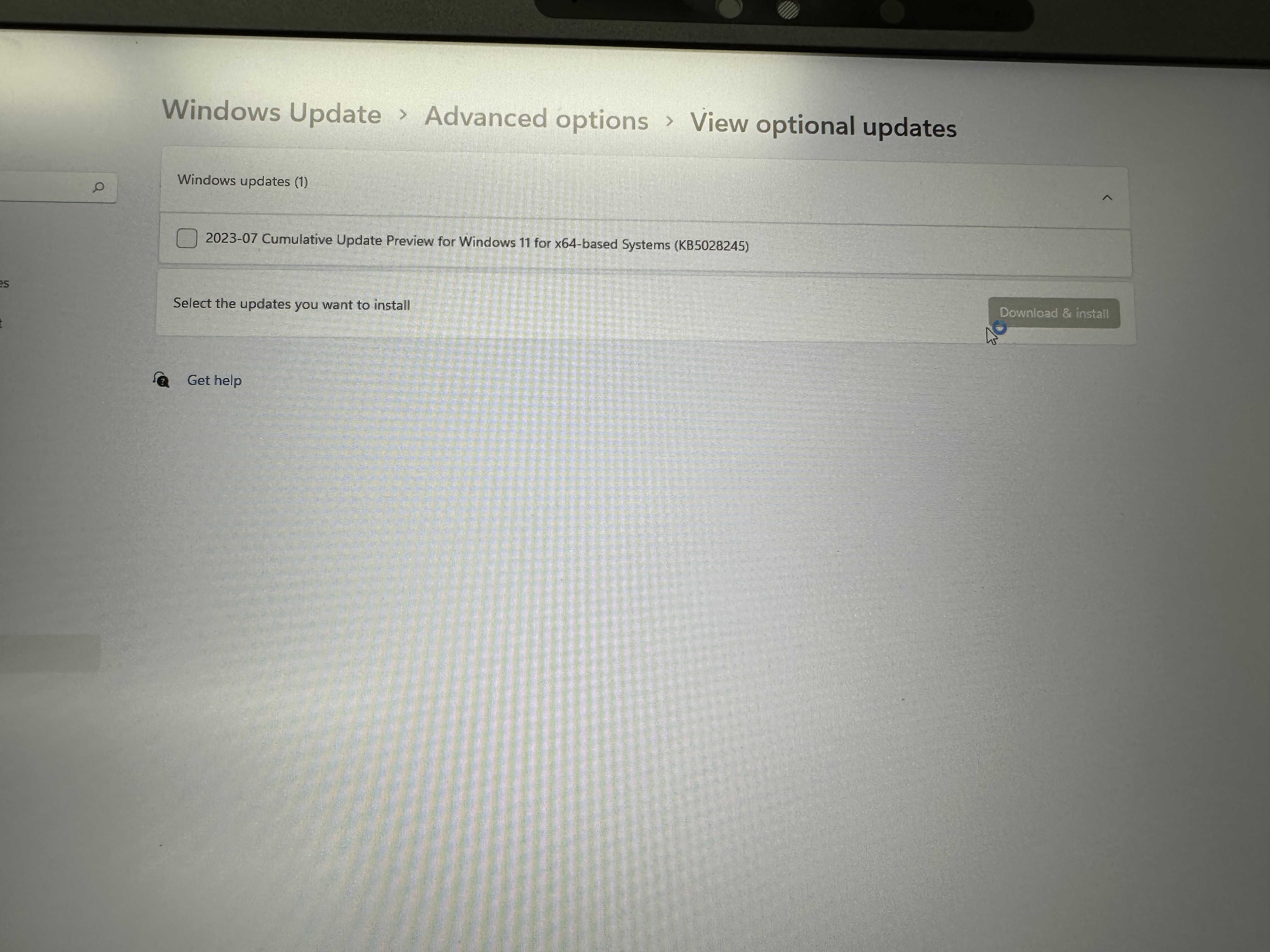

Also, make sure you go to Start > Settings > Windows Update to keep your system up to date, the version you are running is 22000.
After that, please check if that makes a difference.

Just so you know I used the beta intel graphics command center
Also I uodsted through the automatic updates on the intel self updating and there is no pending updates in windows or optional updates and
