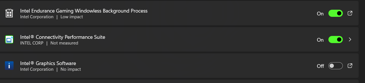

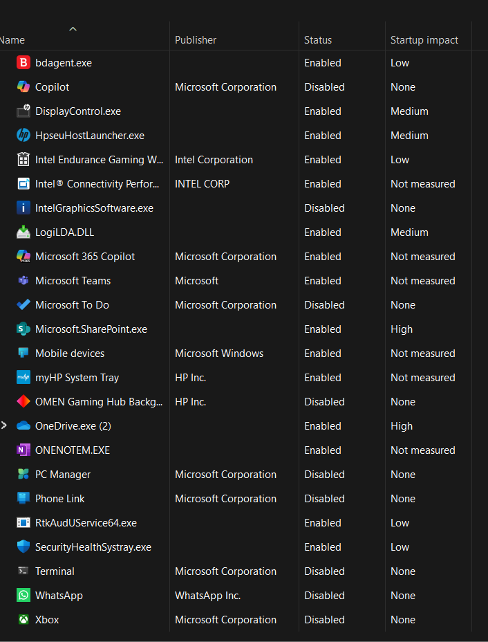

Dear @DarwinC_Intel
Please find attached the screenshot of the error and also my current startup settings. If I enable it, then the error message will appear.
Please advise
