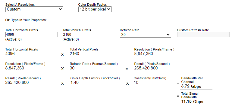

  • Also, HDMI 1.4 has a total BW of 10.2 Gbps and just 8 Gbps is effective, for 4k@30 using 12-bit, you need a bandwidth of at least 11.15 Gbps (check the attachment HDMI-12-bit).
  • In this case, the problem seems to be BW limitation from your motherboard's port, you might want to check with the manufacturer (OEM) directly whether this motherboard has an LSPCON or not. You can check the attachment HDMI-8-bit, the bandwidth will be enough to get up to 4k@30 using 8-bit.
