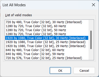

Last summer after a system update of my Lenovo ThinkPad T16 laptop, the external monitor – ASUS ET2311I, an all-in-one solution,– has stopped supporting Full HD.
I contacted Lenovo and followed all their instructions – modifying system settings and manipulating device drivers,– but to no avail: the resolution is 1024 x 768 (Recommended) or 1280x720 maximum.

  1. The problem laptop works perfectly with another external monitor, Dell P2423DE, via HDMI in WQHD mode even.
  2. The problem external monitor works perfectly with another laptop – Lenovo ThinkPad T14 but under Windows 10,– with the same HDMI cable in Full HD mode.
I would be very thankful for your advice on how to mate my devices for Full HD mode. IGCC and SSU reports are attached.

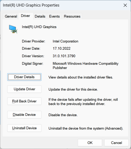

  • The Balanced Power Plan was restored to default settings.
  • Uninstalled and installed Intel UHD Graphics display adapter according to the recommendations from the forum you recommended.
  • Applied the oldest Intel UHD Graphics driver available on your site, Version 31.0.101.4953.
None of this helped to get the Full HD mode.

Rolling back to Windows 11 to Version 22H2 didn’t work: the default display adapter driver from Microsoft didn’t support connecting external monitors. With Windows Update, the driver from Microsoft was immediately replaced with Lenovo (Intel Arc & Iris Xe Graphics) driver version 31.0.101.4575.
In the result, Lenovo ThinkPad T16 Gen 1 failed to support the ASUS ET2311I external monitor in its native Full HD mode via HDMI under Windows 11 Version 22H2, similarly to Windows 11 Version 23H2.
Since Intel and Lenovo web sites do not provide an older graphics driver for my device—dated, say, year 2022, —I proceeded at my own risk with Intel graphics driver version 31.0.101.3790 dated October 17, 2022, which was found on the internet. Amazingly, Lenovo ThinkPad T16 Gen 1 supported—not perfectly, but supported, —ASUS ET2311I in its native Full HD mode under both Windows 11 Version 22H2 and Windows 11 Version 23H2. Screenshots are attached.
The bottom line is that starting in 2023 the Intel Arc & Iris Xe Graphics driver obtained a bug that broke the compatibility of my devices. I suppose that such destruction of compatibility also occurs between the whole class of 12-th+ generation Intel processor-based devices with integrated graphics and a (sub-)class of AIO external monitors, via HDMI. Please deny or confirm.

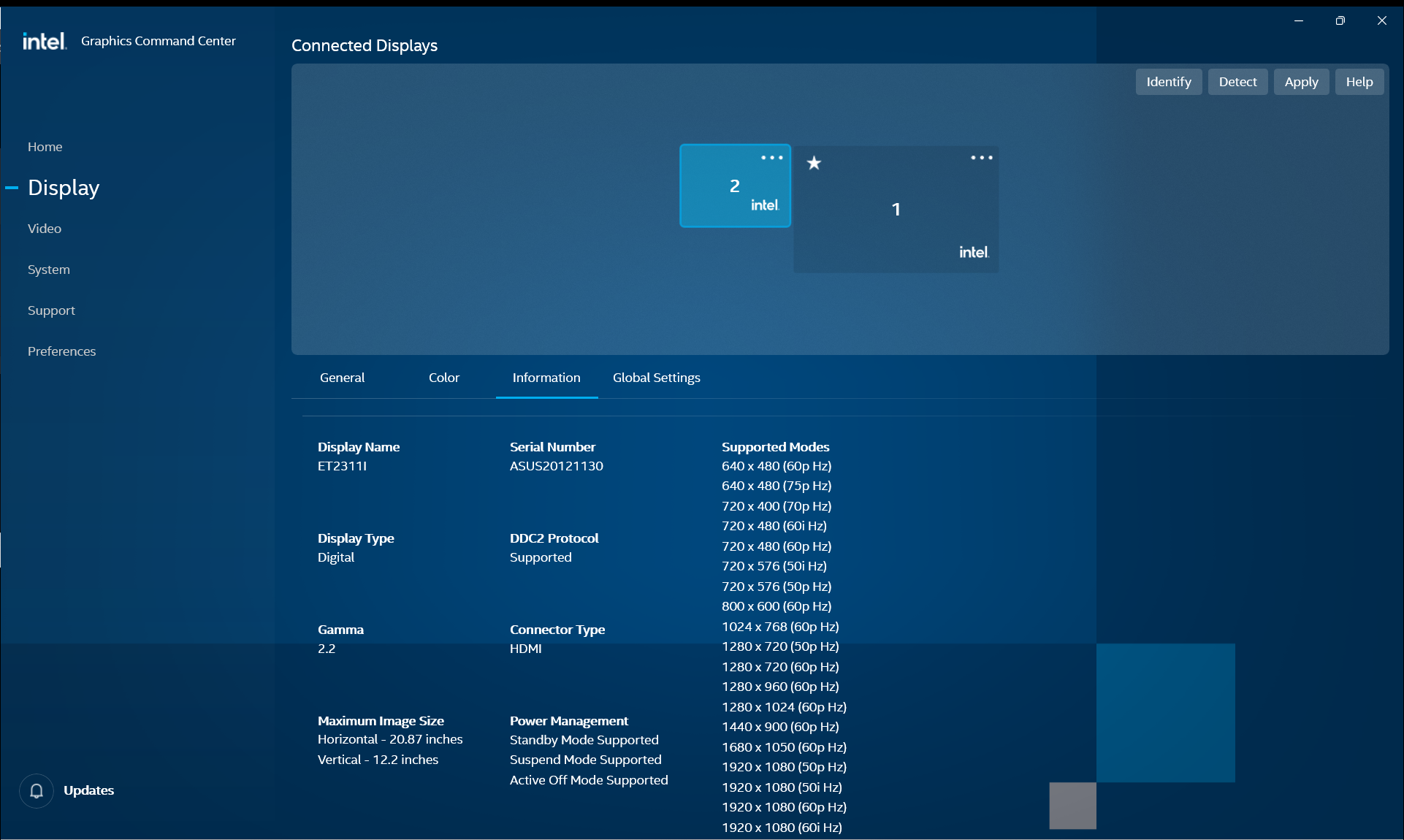

I understand that this is an annoying problem, but I think the cause lies elsewhere. The ASUS ET2311I was manufactured in week 48 of 2012 according to diagnostic data. That was 12 years ago. Since then, standards regarding interface compliance have evolved and I assume that newer Intel drivers have been adapted to meet this compliance.
The monitor shows inconsistent data via the HDMI cable:
GTF = VESA Generalized Timing Formula
The resolutions you describe as functional are below 90 MHz pixel clock. So is 1080i (interlaced = 148.5 / 2 = 74.25 MHz). In my opinion, this is an "error" on ASUS' part, but they are unlikely to correct it with a firmware update for a 12 years old device that was designed to run Windows 8. Simply due to cost reasons.
If you wish, we can use a third-party tool to verify whether my hypothesis is correct.

I can reproduce the problem in my environment and also resolve it. Please follow the steps below.
  • Download Custom Resolution Utility (CRU)
  • Run CRU.exe
  • Make sure the active EDID is that of the ASUS monitor connected to your laptop. If necessary, select from the drop down menu.
  • Remove the GTF range limit data:
Close all windows with OK and restart the computer. You should then be able to drive the display with 1080p @ 60 Hz 148.5 MHz RGB 8-bit.
Background: Extended Display Identification Data (EDID) is sent from each display device to the graphics card to communicate the monitor's capabilities. The method described above overrides the data stored in the Windows registry, i.e. the Intel graphics driver ignores the original GTF data. So you have to run this procedure on every computer you want to connect to the ASUS. The better solution would be a firmware update from ASUS that removes these GTF limits from EDID that this device sends. But that is unrealistic.

  1. To check whether a digital interface works according to the intended standard, there is always a so-called Compliance Test Specification (CTS). This is a document in which many, many test cases are listed to enable manufacturers to ensure that functionality and interoperability are guaranteed with the interface in question. These standards change over time and are usually not publicly available, but are instructions for developers. An outdated version from 2011 can be found in the appendix. See page 213 for the Monitor Range Limits.
  2. The graphics hardware reads the information (Extended Display Identification Data = EDID) that the monitor specifies for its operation via the HDMI cable on the so-called Display Data Channel (DDC). I am not a developer in this area, but it seems logical to me that current driver tests in this case look like this:
    - The monitor sends that it can handle 1080 @ 60 Hz both Progressive Scan and Interlaced. A pixel clock of 148.5 MHz is necessary for Progressive Scan.
    - At the same time, the monitor sends that it only allows a maximum pixel clock of 90 MHz.
    - So the least common denominator wins (90 MHz) and 1080p is not allowed because it would mean violating the global pixel clock limit of the monitor. It is unlikely, but theoretically violating limits can also lead to damage. If that were the case, Intel would be accused of breaking monitors. The monitor manufacturer has the final say on what their device is allowed to do and must unambiguously define this via the EDID.
  3. The whole issue is a chicken-and-egg problem and one can of course argue who is to blame. ASUS, because they send that the monitor can only run at a global maximum of 90 MHz, or Intel, who previously ignored this limit but now stick to it, which is probably intended in the current CTS. It is impossible to maintain backwards compatibility forever. At some point one just has to update hardware. The cheapest ASUS Full HD monitor, released in 2023, costs less than $100.
