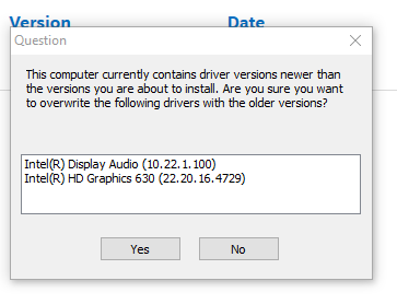

Hi guys,
So basically I am unsure which Intel Graphics Driver is the latest on for me... On the Intel Driver Update Utility it did a scan and then the results shows that my current installed version is 22.20.16.4729 however, it says that the latest version is 15.45.19.4678. I am unsure if I should replace my current installed version please help...? Also, I tried to proceed and it pop up a message saying 'This computer currently contains driver versions newer than the versions you are about to install. Are you sure you want to overwrite the following drivers with the older versions?. From this point, I do not know what to do now... please help. Also, in the screenshots it says for the chip-set that the installed version is 22.20.16.4729 however the latest version is 15.46.05.4771.
Also, I have attached screenshots.
Looking forward to your guys response.

It's an issue in the utility i have already reported:
Indeed the latest version is 15.46.05.4771.
Ignore that the utility says "chipset" and install it if you want to be up-to-date.
Also check out: https://www.intel.com/content/www/us/en/support/graphics-drivers/000005654.html Understanding the Intel® Graphics Driver Version Number

Hi Stefan,
Thanks for the response.
So are you saying that currently my versions are indeed old and that I should proceed > So should I proceed and install 15.45.19.4678 (Graphics) and 15.46.05.4771 (Chipset)?

Install only 15.46.05.4771 - it's a graphics driver, just wrong labeled.
You can also get it here and read the change log: https://downloadcenter.intel.com/download/27058/Graphics-Intel-Graphics-Driver-for-Windows-15-46- Download Intel® Graphics Driver for Windows* [15.46]

Okay, I will do as you suggested and begin to install only 15.46.05.4771.
