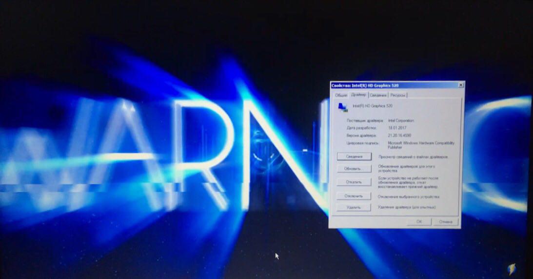

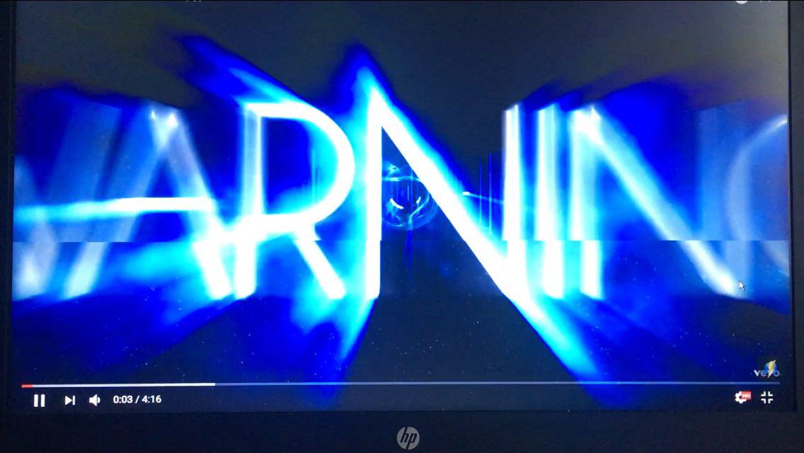

I have a trouble with Intel HD 520 video.
Examples of lag at photoes below:
It doesn't a metter which resolution of video selected and also doesn't a metter wich screen resolution is set.
I try to reinstall video driver (by uninstalling, reboot and install again) to newest one. I also updated BIOS version of my laptop HP EliteBook 850 G3 (T9X19EA) and situation still the same.
Also, my collegue has the same laptop and the same problem.
I can't install driver directly downloaded from Intel website, because installer call errror window with text like "you should install driver for your laptop brand version", thats why I installed from HP site.
Lags also appears when I connect laptop to monitor via display port.

Hello Amy,
It's a russian localization, but version is readable:
It's happening in every video player, not only in browser. For demonstration I downloaded video viewed earlier on youtube (on screens above) and played in Windows Media Player as a standard player and Power DVD as preinstalled on my laptop. I've got next result:
During a test with Windows Media Player I played video few times and lag appear only one time:
During test in Power DVD lags appear all the time, such as in youtube and other video players:

Unfortunately, situation still the same:

Finally I have found the cause of problem. Once again I'm convinced that Windows and HP sucks.
The cause of problem is personalization (theme). I prefer classic theme, that use less RAM/CPU/VideoMemory.
When I switched to default theme - lags disappeared.
https://youtu.be/4bbeJ7lIWDU windows or intel bug - YouTube
I'm sorry the time I spent to find this *swearing*.
Thank you Amy for help!
Intel community at least tried to help me unlike HP community that only ignoring.
If somebody else will face with lags like this, try to make next steps:
1) update BIOS version and reset BIOS settings to default
2) update Video drivers manually, using Amy's advise above in this topic
3) read this: (configure in the Windows 7 energy plan the options of Intel Graphics Settings to 'Maximum Performance'. no matter if it uses the laptop battery or via power supply)
4) switch appearence theme to default windows aero.
