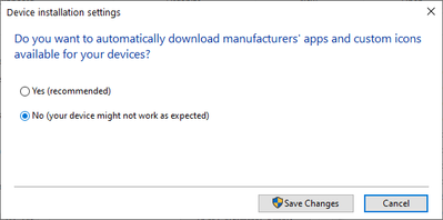

  1. I followed the steps you recommended. On top of it I disabled W10 automatic driver update (https://www.laptopmag.com/articles/disable-automatic-driver-downloads-on-windows-10) as I may need to go online again at some point.
    1. It seemed to work! At least I was without issues for 24 hours. But then, guess what, W10 updated the driver and I’m back to where I was before.
    2. I’m a bit surprised by the fact that:
      1. Acer provides the driver version 17.07.2015, 10.18.15.4256 for download (causing the problem), which is automatically updated by W10 to
      2. the Windows enforced driver version 04.08.2015, 10.18.15.4248, (causing the problem as well),
      3. while the Intel driver version obtained by the method described above (15.05.2020, 20.19.15.5144) seems to work just fine, but it is again overwritten by W10 with the 5 years older version of the driver causing the issues.
    3. I’m even more surprised by the fact that W10 is enforcing his driver version even though I told it not to do so (https://www.laptopmag.com/articles/disable-automatic-driver-downloads-on-windows-10) .Peter-blablablabla_1-1603990420165.png
    4. So I guess my next challenge is to make W10 stop updating the GPU driver, which I have not jet solved.  Any idea on this?
Many thanks!!

Usually, if you do a clean installation without internet access (following our steps to the letter), Windows will not force you to install a different driver, however; this is not always the case.
In this case, I do not have another recommendation for disabling automatic updates, you may want to check with Microsoft* for more recommendations on this.
