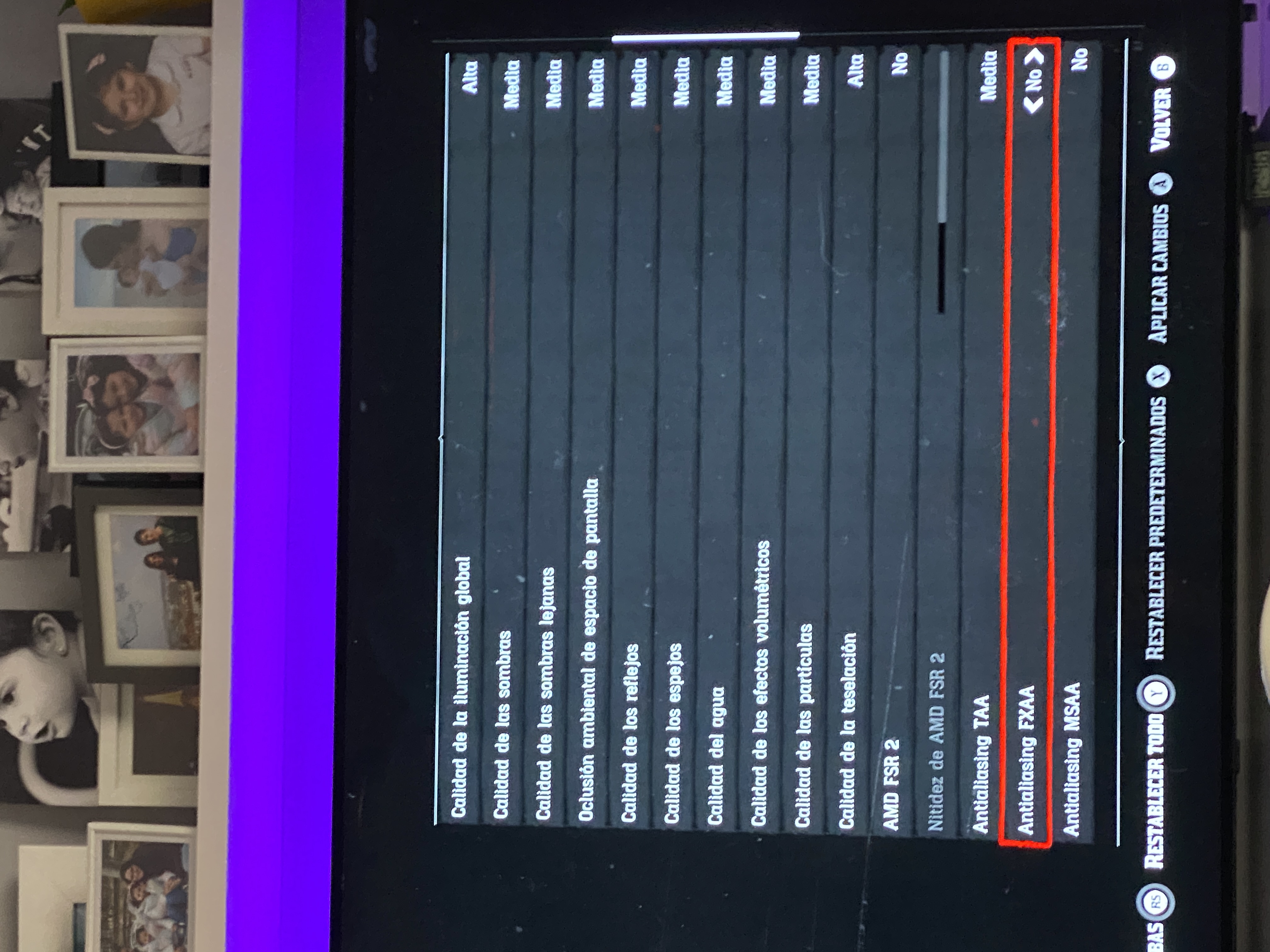

Hello, I have this GPU working fine in 4K resolution.
I try to play some games with 60pfs and low, medium or high settings, in order to have 60fps smooth...but I dont know why every some time like 30 seconds approx., it drop from 60fps to 58 or 59 fps and there is no a clear reason, cause the gpu and cpu are working stable and good temperatures, no reason for this unpleasant descent.
I would like to know if there is any settings I might be forgetting, of course I have rebar ON and all the drivers from chipset and gpu updated.

For example in RDR2, if I select 60fps it drops to 59 several times and if I change to max 59, it drops to 58 several times.
