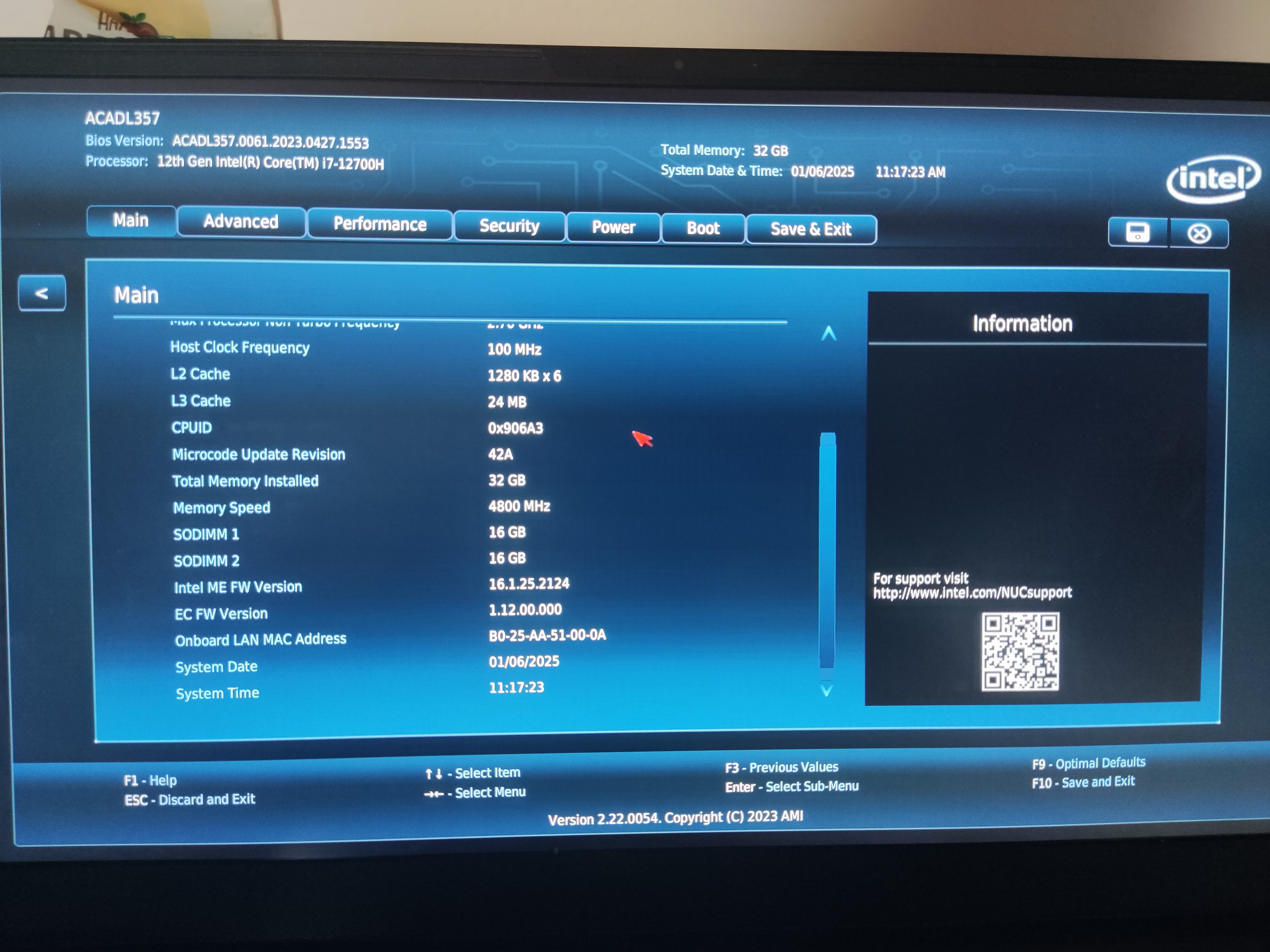

Foxle
5,483 Views
My BIOS interface info, I don't think I found the graphics card
JedG_Intel
5,422 Views
Hi Foxle,
I appreciate your effort. I'll be conducting an investigation about this matter and I'll get back to you as soon as possible.
Jed G.
