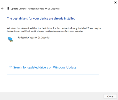

This did not work for me. When hitting next, it returns the following.
Stefan3D
4,594 Views

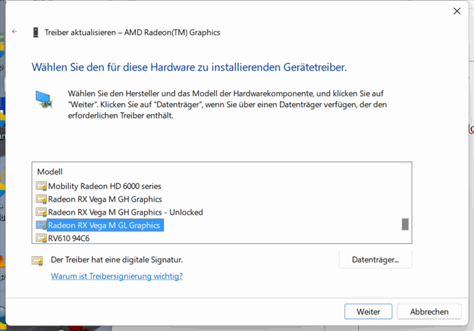

@exspell
this happens if you do "manual installation" where you point to a folder instead of "have disk method" described by Alberto.
Did you reach the window attached below?
exspell
4,574 Views
Thanks! That worked!
