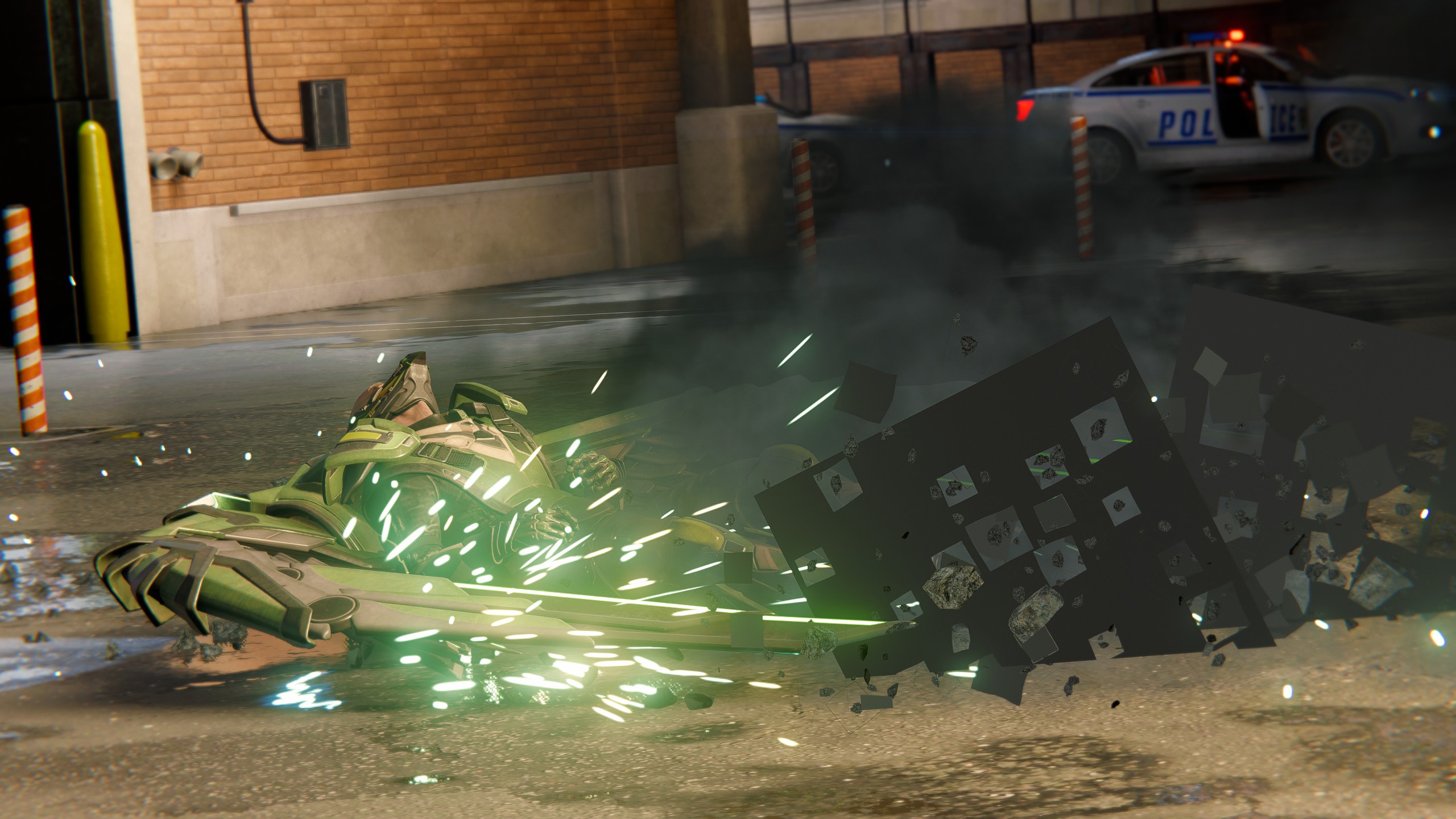

There is a screenshot in the above link identical to what I am seeing. There are a few posts with this issue and they all seem to have B580s.
When did the issue first occur?
I first noticed it in the helicopter scene where you have to stop it, a lot of explosions happen there
Have you made any software or hardware changes to the system recently? No
Have you noticed any signs of overheating in the system? No
Are you using the latest Intel Arc driver version? Yes
Have you attempted a clean driver installation using a tool like DDU to ensure no remnants of previous drivers are causing conflicts? I did this when I installed my B580 but have not since, only intel drivers are on my PC.
Are there any other applications running in the background that might interfere with the game's performance or graphics rendering?
No
Does the issue occur consistently after a specific in-game event or location, or is it purely time-based?
Occurs during explosions.
Have you tried reinstalling the game completely to rule out corrupted game files?
No, other forum posts that have this issue tried that to no avail.
On which digital distribution platform did you install Spider-Man Remastered (eg, Steam, Epic Games Store)?
Steam

I attached the 2 files as requested.
Monitor: MSI MAG275QF
I am using a display port connection with no adapters.
PSU: CORSAIR RM650 80 Plus Gold Fully Modular Low-Noise ATX 3.1 PCIe 5.1 650 Watt Power Supply - NA - Black
For reproducing them, they occur during explosions. The most prevalent time they appear is during the helicopter mission when you are running through the building and the artifacts appear consistently. This is the mission: Straw, Meet Camel. A good example would be playing the section starting at 12:43 through 13:05 in this video: https://www.youtube.com/watch?v=BctmSf-eLgA&t=762s (Although this video does not show the artifacts)

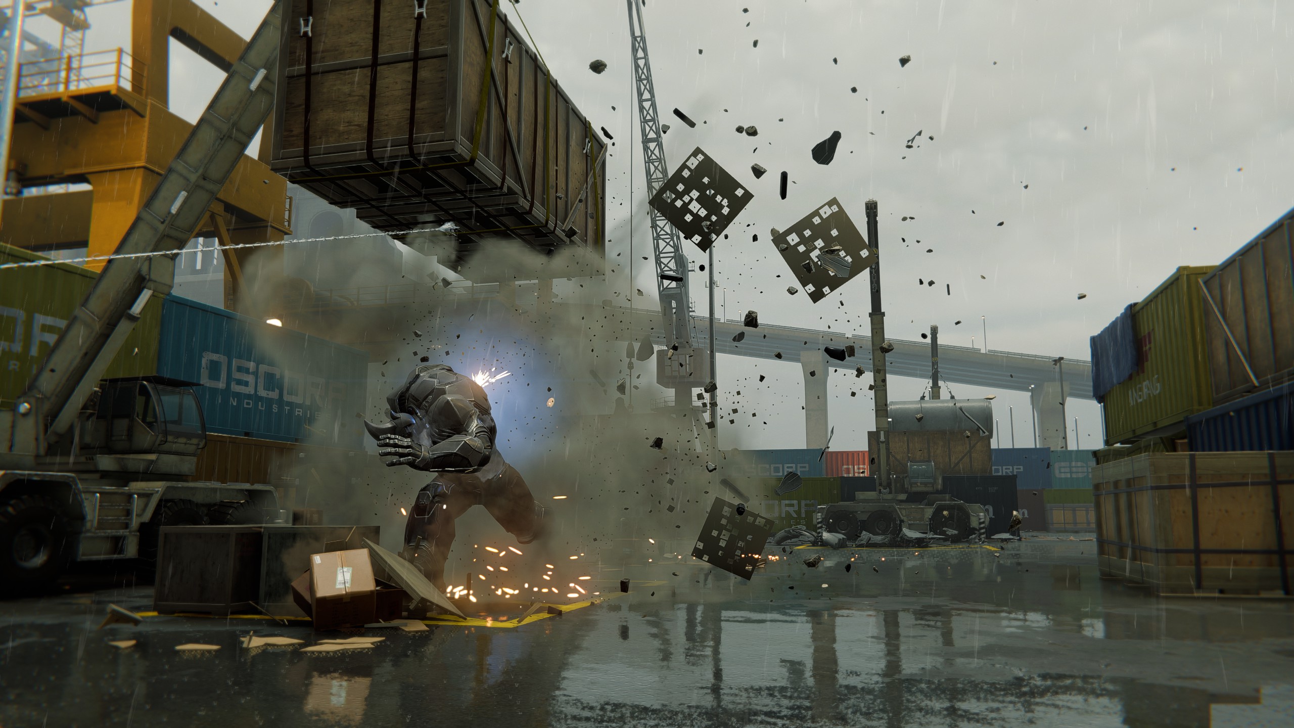

I just updated to the latest driver: 32.0.101.8136. It looks like this driver came out after I created this thread. I booted up spiderman and during a quest fight I noticed the same artifact appear. It happened too quickly for me to get a screenshot but it was not an explosion this time, just during the knocking out of the final enemy (when the game slows down slightly on the final move) the same square artifact appeared (similar to the screenshot provided). Was something in the latest drivers made to address these artifacts in spiderman?
Here is another example of jumping from an explosion.
A few more examples as well:
The Rhino/Scorpion fight is especially egregious with this artifact; this might be the best point in the game for testing.

All of the above screenshots are on the latest 32.0.101.8136 where I use a clean install via the intel software center. I have no pending windows updates. I'll look into the motherboard update but that came out the day I made my initial post and SSU log. This issue for spiderman has persisted across multiple different users (various internet threads) over the past few months. Was something in 32.0.101.8136 specifically added to address this issue?
