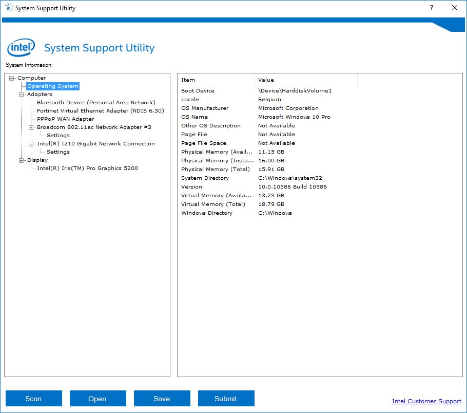

I have a Macbook Pro 15" 2015 with an Intel Core i7-4980HQ and Intel Iris Pro 5200 graphics (discrete IGP only, no Nvidia card).
Under Windows 10 Treshold 2 (v1511) (bootcamp) one of the eight cores is continuously used by the System and compressed memory process when the Intel driver is used for the discrete graphics. When the Intel driver is uninstalled and I revert back to the Microsoft driver the problem goes away.
The problem also happens only when you do a cold start (after shutdown) or reboot. If you put the laptop to sleep or hibernate to problem also goes away. So the workaround for now is not do a reboot or shut down but hibernate or sleep.
I have tested this with the Apple provided drivers for the Iris Pro and the latest drivers from Intel: https://downloadcenter.intel.com/download/25489/Intel-Graphics-Driver-for-Windows-10-15-40-4th-Gen- Download Intel® Graphics Driver for Windows® 10 [15.40][4th Gen] version 15.40.10.64.4300.
The problem is easily reproducible: uninstall the Intel Iris Pro from device manager and tick "remove driver software" and after a reboot the problem is gone. Reinstall the Intel Graphics Driver and after a reboot the problem is back. So I suspect somewhere along the line there is a conflict between the driver and Windows 10. Since the issue can be solved with sleep or hibernate I'd suspect something with the ACPI driver.

Cold boot or reboot causes high CPU usage from Windows System and compressed memory process
Does it fail every single time, or only sometimes?
If you can offer a % rate please do.
100%
Hardware (HW)
Brand and Model of the system.
Apple Macbook Pro 15" Mid 2015
Hybrid or switchable graphics system?
ie Does it have AMD or NV graphics too?
No, discrete only
Make and model of any Displays that are used to see the issue (see note2 below).
LFP = Local Flat Panel (Laptop panel)EFP = External Flat Panel (Monitor you plug in)
Both:
- LFP
- 2x EFP (Dell U2715H)
