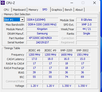

- What is the specific make and model of your RAM?

ram - HyperX DDR4-3200 8192MB PC4-25600 Fury RGB Black 4x8gb 4 slots used Xmp Enabled 3200
mobo PRIME H670-PLUS D4
bios settings ok,cpu no power limits and good cooling
