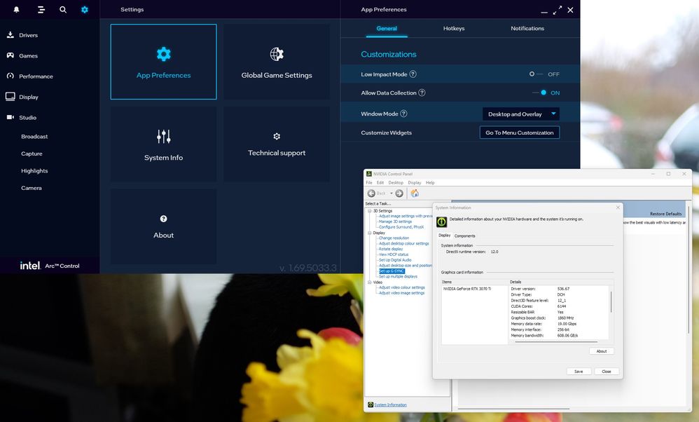

So... I uninstalled latest Nvidia drivers 536.67 and clean installed 531.79, result Intel Arc overlay working now!! until I rebooted then back to same as before

I uninstalled Arc control 1.70.508.... then by clean install Intel 4502 drivers which took me back to Arc version 1.69.5033.3 reinstall 4578 drivers but I unticked "Update Arc control"... overlay works now. So now hoping a fix for Latest Arc version soon.
