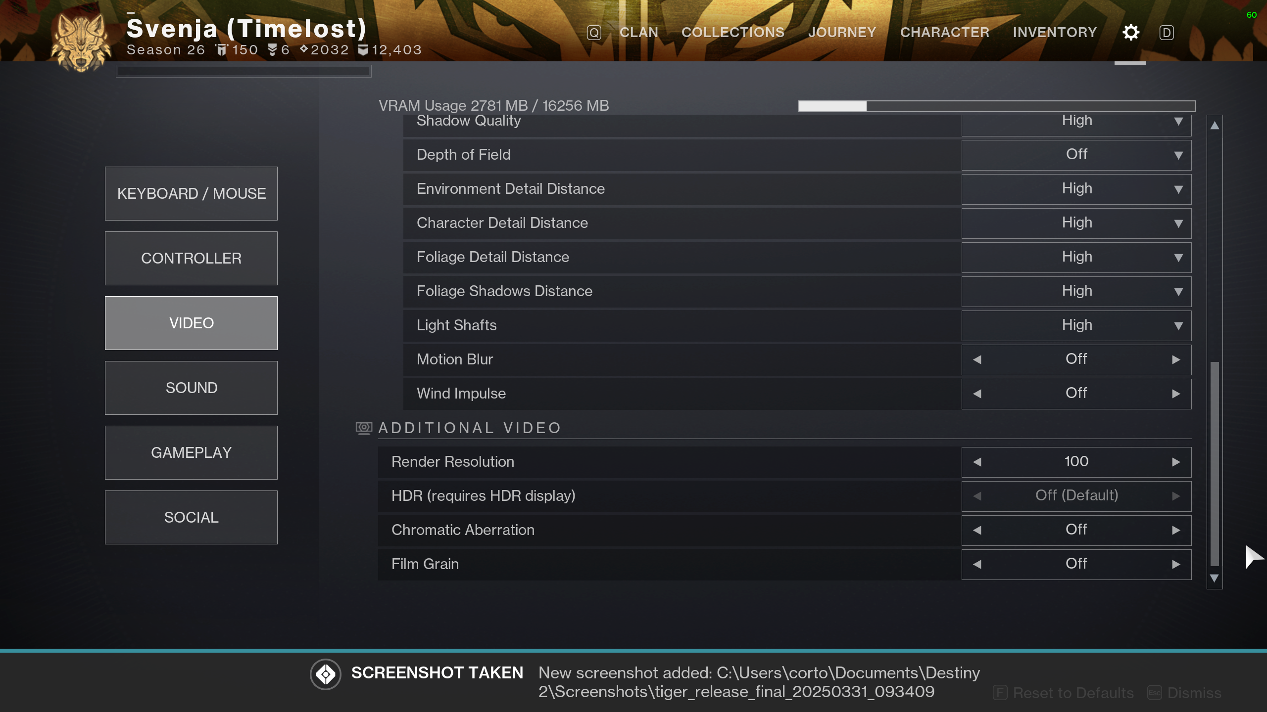

Hi RomainFR,
Thank you for trying the DDU. It appears that exiting the character menu results in the game freezing. Before I proceed with further investigation, I realized I forgot to ask for your in-game graphics and display settings. Could you please share a screenshot of them? This will help me accurately replicate and investigate the issue.
Dhanniel M.
Hi RomainFR,
Thank you for sharing your game settings with me. I will investigate this matter further on my end and provide you with an update as soon as possible.
Dhanniel M.
