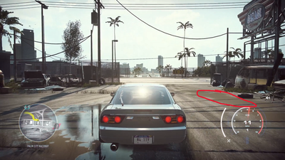

Hello, I compared the footage of the game that you tested with the b580 and can see the same texture problem, I have circled it and put the picture in the attachment
If you wish to observe the issue more clearly, please proceed to the locations marked on the game map; this problem appears to occur only on earthy terrain.
Then you may see a scene similar to mine.
I tried using DDU and it didn't work
I turned off the HDR and it didn't work either

Hi @TheZX,
Thanks for providing additional information. I've successfully recreated the issue you've cited.
Allow me time to further investigate the issue and provide you an update as soon as possible.
