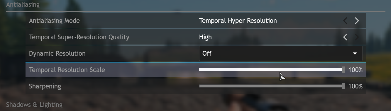

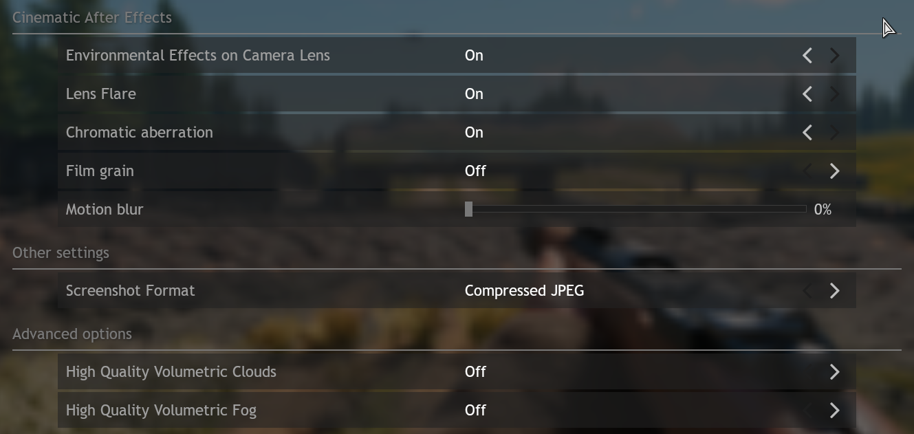

Jacob07
1,977 Views
Hello, Von M.

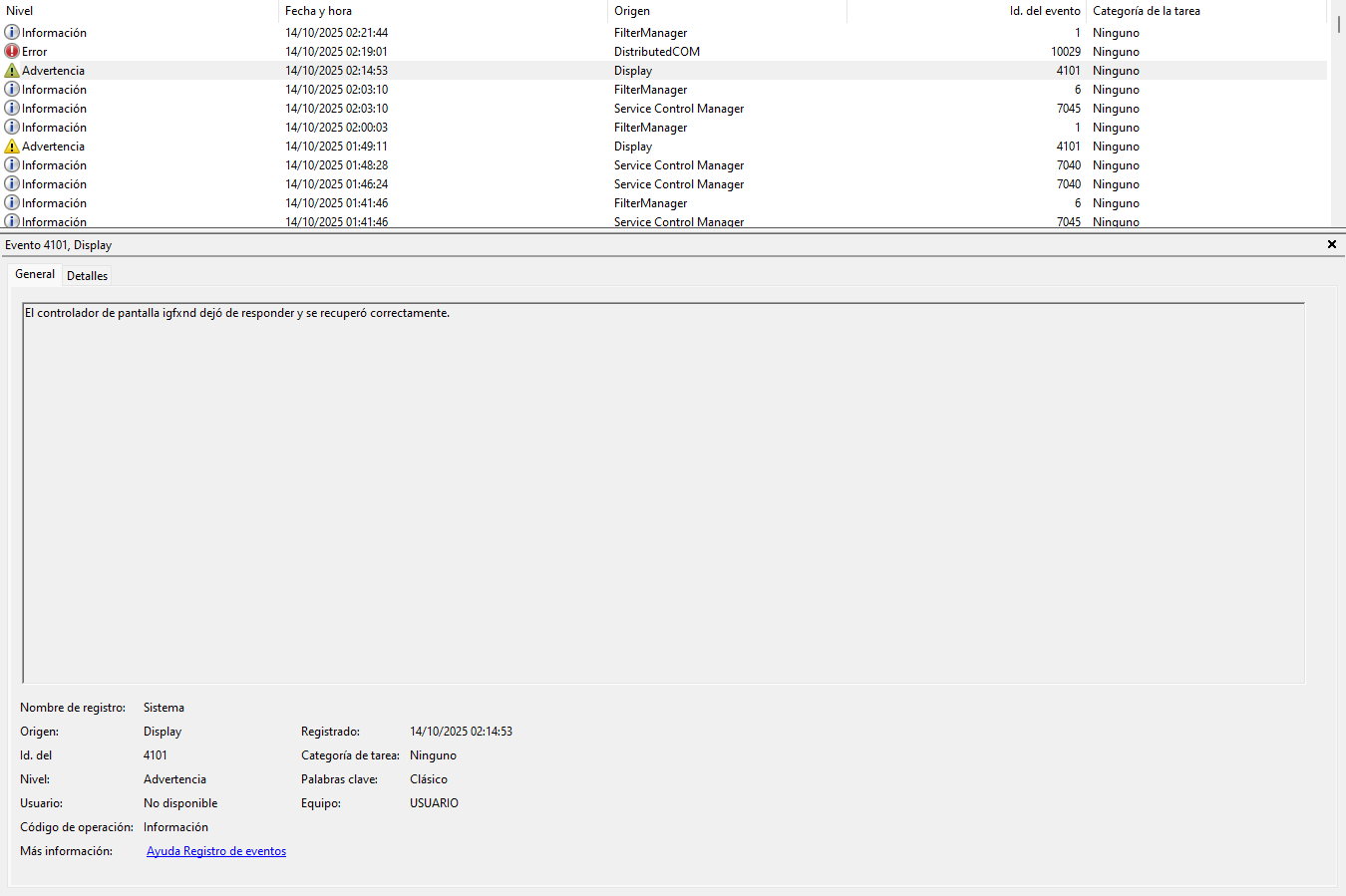

I did what you said. I played two matches, and in both of them, the game froze once, but it unfroze both times, I was lucky.
Checking the Windows Event Viewer after both matches, I found that these two errors appeared in the exact minute the game was freezing:
The first freeze happened at 1:49, and the second occurred in 2:14. In the Windows Event Viewer, it shows two warnings that match the moments the game froze. I'll share the screenshots and files, but since they're in Spanish, I'll also try to translate them here.
I'll also attach screenshots of my current in-game graphics settings.
First warning
Level: Warning
Date and Time: 14/10/2025 01:49:11
Origin: Display
Event ID: 4101
Task category: None
General: "The igfxnd display driver stopped responding and has recovered successfully."
Details: +System
               -EventData
                                           igfxnd
Second Warning
Level: Warning
Date and Time: 14/10/2025 02:14:53
Origin: Display
Event ID: 4101
Task category: None
Details: +System
               -EventData
                                           igfxnd
You mentioned that you were able to replicate the freezing behavior, but with different error messages. After the game unfreezes, many different errors can appear, "[E]DX12: Trying to read debug layer message queue...", just happens to be the most common. I use DirectX12, and it only happens when using DirectX12.
Best regards.
VonM_Intel
1,705 Views
Hello @Jacob07,
I truly appreciate how thorough you’ve been in gathering the information, including the Event Viewer logs, translations, and in-game settings. The warnings you captured, “The igfxnd display driver stopped responding and has recovered successfully”, confirm that the freezes are being triggered by the display driver briefly timing out and then recovering. It’s encouraging that your system was able to recover both times without requiring a reboot, which suggests the issue may be software or driver-related rather than hardware failure.
In the meantime, I'll need to conduct additional research on this issue and will post an update in this thread once I have more information about this matter.

RandyT_Intel
431 Views
Hello @Jacob07,
After investigation, we've determined that this appears to be a game-specific issue that affects multiple GPU models, rather than a hardware-related problem. We'd like to direct you to these community discussions where other users have reported similar DX12 freezing issues and potential solutions:
Since this appears to be a game-specific compatibility issue with DX12, we recommend contacting the game developer directly for further assistance and potential patches or workarounds.
For the separate DX11 flickering objects issue you mentioned, please create a new support thread as we can only address one technical issue per thread. This will ensure your DX11 concern receives proper dedicated attention and troubleshooting.
Thank you for your understanding, and please don't hesitate to create that new thread for the DX11 issue.
