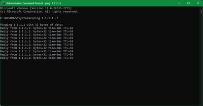

open a cmd prompt as admin
try this and see if you have disconnects.  the better option would be to ping your router locally to rule out an isp problem.
typically its 192.168.0.1  or 192.168.1.1
from command prompt run  ipconfig /all  you can find your gateway here to ping.
if you see any timeouts or huge spikes locally then you may def have a nic problem.  if not it could be your isp or someone in your home downloading or uploading files?  even phones on the wifi backing up photos.
what are your internet speeds?  download and upload?
Noganite
7,329 Views
Tested using Fast.com I just spoke to family that has the same ISP and it may be an internet issue. I tested my second PC and it is on wifi and the upload is the same result as this and the speed down is a little slower. Issue is that low upload should be at the same level as the download; synchronous 1Gpbs and normally it is. This may be the best form of coincidence as the issue cropped when I installed the new GPU; same time. I will find out tomorrow if it improves or what not, to see if it is an issue. I appreciate the assistance and will get back to ya on the forum tomorrow (still early Friday eve for me). I so want Intel to succeed and am willing to get the adopter "tax" to assist! Kudos to you and talk to ya tomorrow!

Turns out it was an internet issue. I will say though, if it is not an internet issue for someone, the things you showed and helped me to do to resolve it, you need more kudos! I think these steps can help out and I appreciate the assistance. If I have anything else come up, I shall post it in the forums. Have a great weekend!
