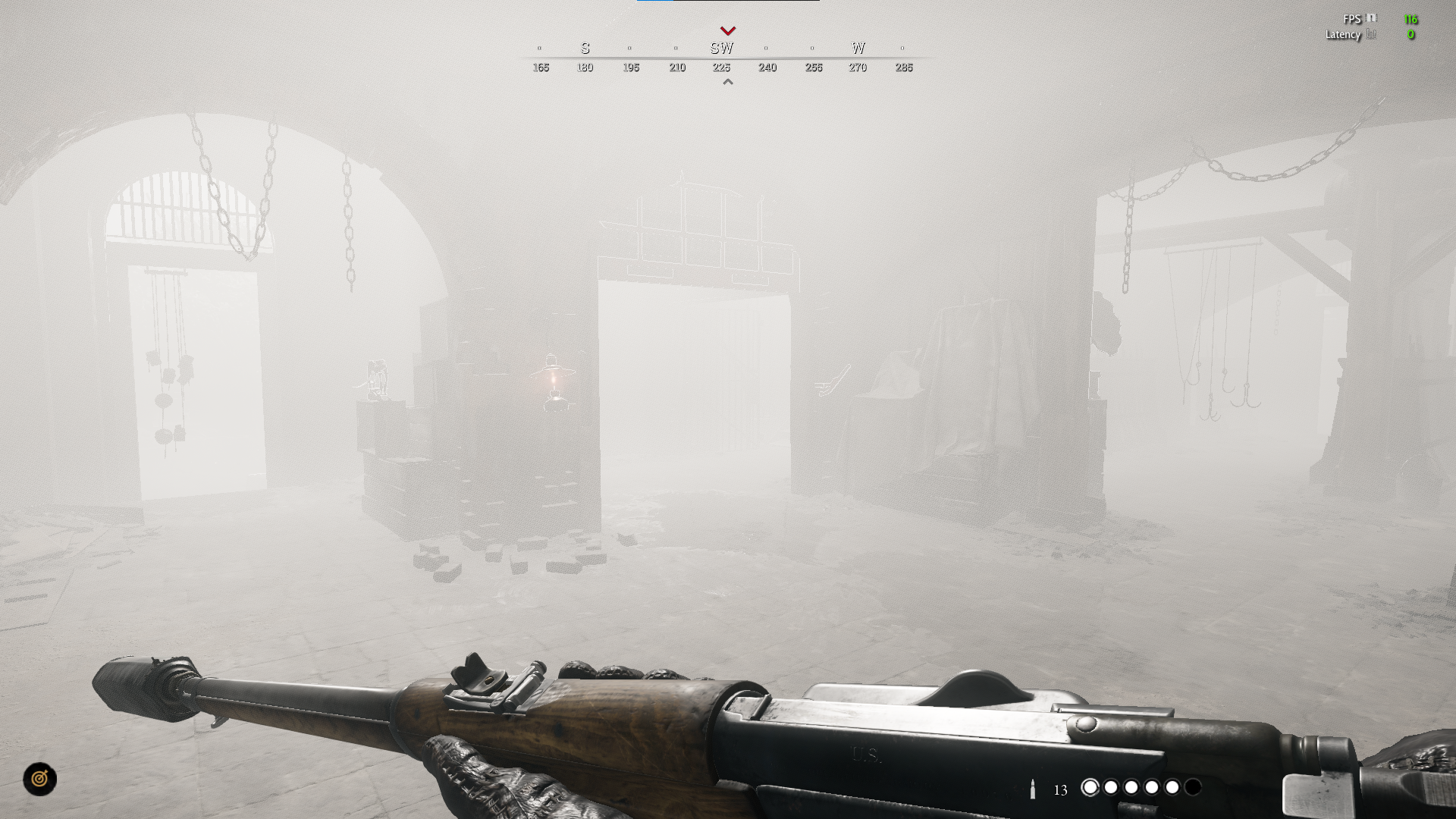

I recently bought an Intel Arc B580 hoping to get a performance boost from my 2060.
It definitely gave a performance boost, but it also made the game unplayable.

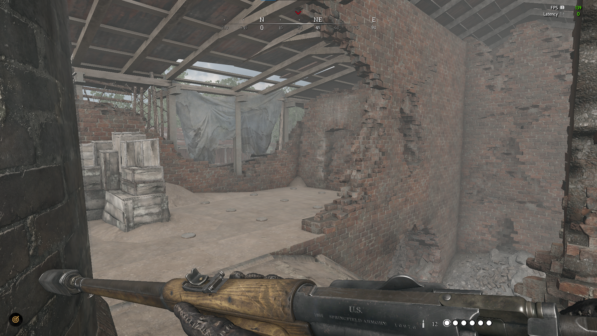

When I entered some (not all) buildings there's this really dense bright "fog" that makes it impossible to see 10 meters out from POV. Basically, if I want to play the game and have a fighting chance I would have to avoid anything to do with buildings on Hunt Showdown.
However, if the building in question has some "natural" light going into it like through a hole in the roof or wall, the fog seems to mostly disappear.
Also sometimes, you can't even look into the insides of the buildings, because the "fog" is just so thick.
Screenshots are attached.

OofBooper
2,231 Views
Hi Dhanniel,
Thank you for the reply.
Yes I have ussed DDU to uninstall the Nvidia driver before installing the Intel drivers.
I have attached a screenshot of the low present settings on my game.
The platform I downloaded the game and play from is steam.
This issue occurs in every game mode. Like I said it's some buildings. The best example would be if you go into the shooting range mode and go into the main building you will see the very dense fog.
The dense fog is not caused by items like grenades or anything. It just is there only in the buildings for some reason.
I also tried reinstalling the intel drivers with a clean install and it did not fix the problem.
Neither did reinstalling the game.

OofBooper
1,667 Views
Hello Dhanniel,
Your game graphics looks a lot different from mine, I do not know why?
Here is a video of what it looks like from my end.
To clarify, I do not have to do anything to replicate it, it's just constantly there when I load in.
I have also shown my settings again in the same video.
https://youtu.be/M09fvryThMk
