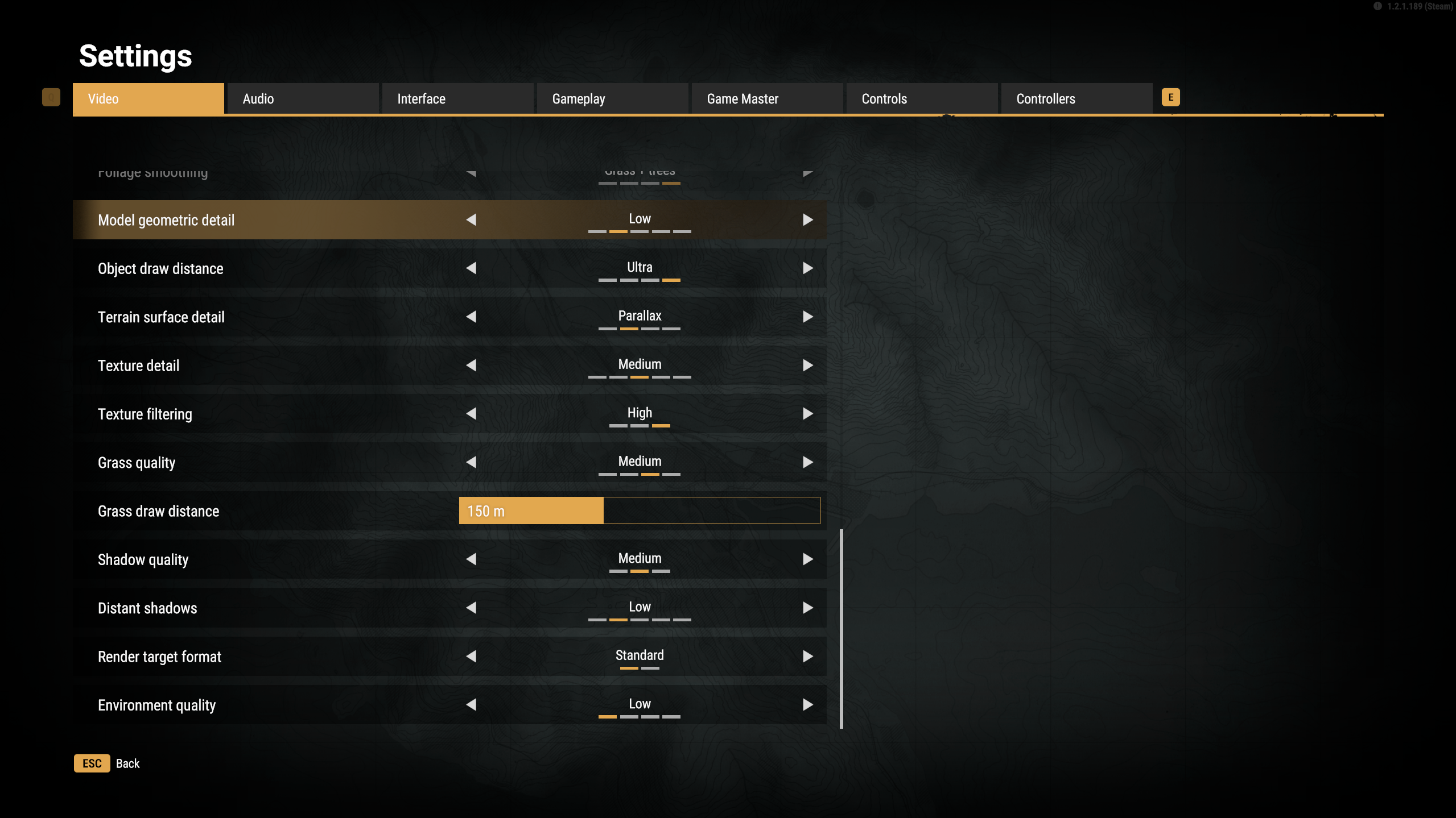

I'm struggling with some rendering issues on Arma Reforger. Especially, when I play on modded servers, the buildings, items around me and trees are taken a long time to be rendered. Also, while I'm navigating around the map, the problem is still there. I have to wait at least 20 seconds for the environment to be rendered correctly. The problem occurs on official or vanilla (not modded) servers as well. At first I was thinking there is a problem with the game but other graphic card brands have no this issue. I've checked my SSD too and there is nothing to do about it. So I decided that it is all about my graphic card.
I think, my system is pretty good to run this game smoothly. Any solutions would be great!

Please find my answers below:
  • I downloaded ARMA Reforger from official Steam Store.
  • I have other games in my library like Dayz, GTA V, Delta Force. None of them has this issue. They are running perfectly.
  • Yes, I tried all the in-game graphic settings as lowest but the issue persists.
Here is the system req. for ARMA Reforger stated on Steam. My specs are suitable for the recommended ones I think. I have Windows 11 btw if it's important;

Please find my current in-game graphic settings and SSU screenshots and SSU report as an attachment.

I found the solution in my tests. I go to BIOS and turn the Resize Bar option off. Then log in to the game and booom, the issue fixed. I tried on 5-6 different servers both modded and official.
However, since I turn resize bar off, now I'm struggling with low fps. When resize bar is on, I had 85-90 fps. When it is off fps dropped to 45-50. And also, some screen distortion issue came up.
I bought this system only for this game (converted from PS5) and choose Intel Arc B580 as a graphic card because of its price and performance ratio. I was an older Nvidia user. Now I do not want to have a dissapointment due to a bad choice.
I need to turn the resize bar on to have a better fps in this game and the other games I'm playing. But this game is unplayable because of this rendering issue al the time. Can you fix this issue please? It would be great if there is possible solutions on newer drivers.
