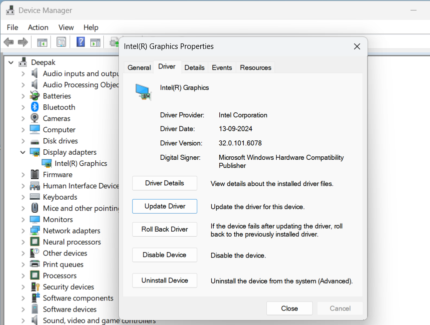

In the product specifications, it says this processor comes with Intel® Arc™ integrated graphics. However, in Windows (Device Manager / Task Manager), it only shows Intel(R) Graphics instead of Intel Arc.

- Could you please provide a screenshot of the relevant tab in Device Manager, specifically under Display Adapters, so I can review what’s being detected?

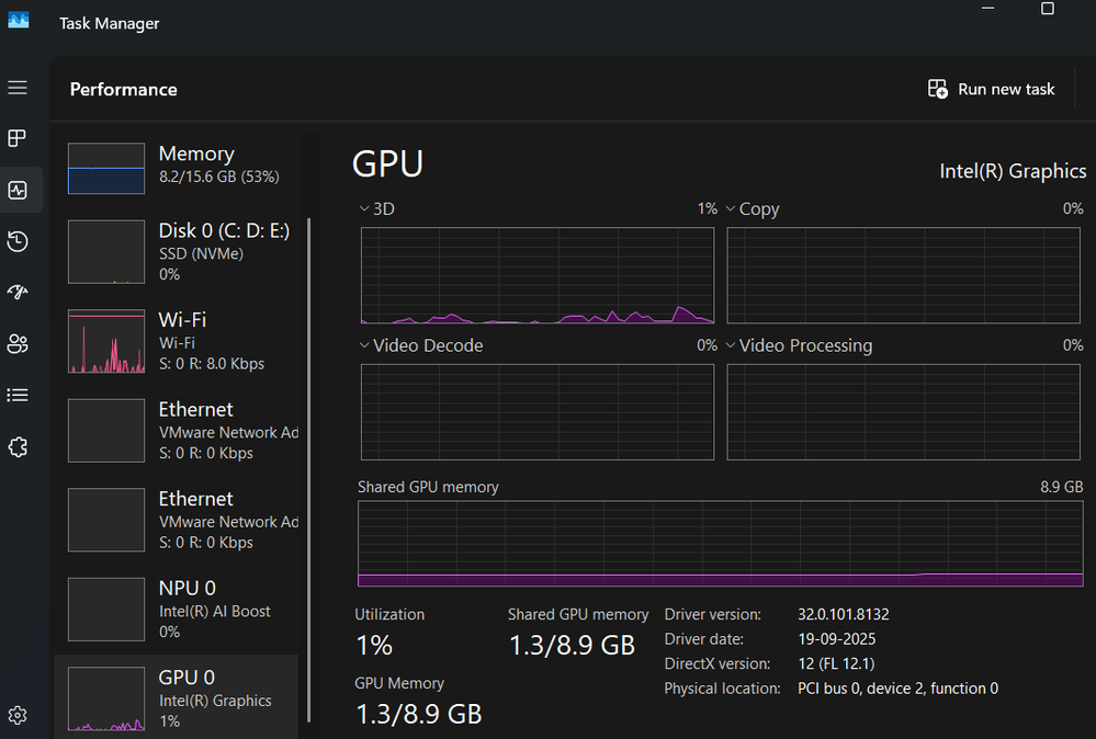

Performance issues: I am not facing major performance problems right now, but I would like to confirm if Arc is active, because in all menus it only shows “Intel(R) Graphics.”
Intel software check: In Intel Graphics Command Center, it also shows only “Intel(R) Graphics,” not Arc.
Device Manager screenshot: I provided below.

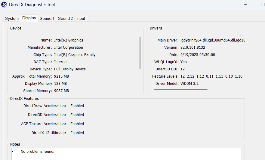

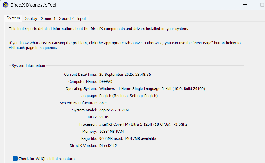

Mine also same issue from 2 days i am also searching on that . It is showing Intel (R) Graphics in Task Manager and in DirectX Diagnostic tool . My Laptop is Acer Aspire Go 14 with intel core ultra 5 125h with 16 gb ram and 512 gb ssd .

Hi @user397,
During our discussion regarding this concern, I can now confirm that it aligns with the previously reported case involving Intel Iris Xe graphics.
Here’s a detailed explanation:
- DDR5 memory features an internal dual-channel architecture of 32-bit x 2, which does not qualify as a physical dual-channel setup.
- For optimal performance, physical dual-channel memory must be configured as:
- 64-bit x 2 for DDR4, or
- (32-bit x 2) x 2 for DDR5 — meaning two separate RAM sticks.
Therefore, to unlock the full potential of Intel® Arc Graphics, a true dual-channel memory configuration is required.
We plan to create and publish a public article to clarify this topic, similar to Intel articles 000059744 and 000094617, once it receives internal approval.
