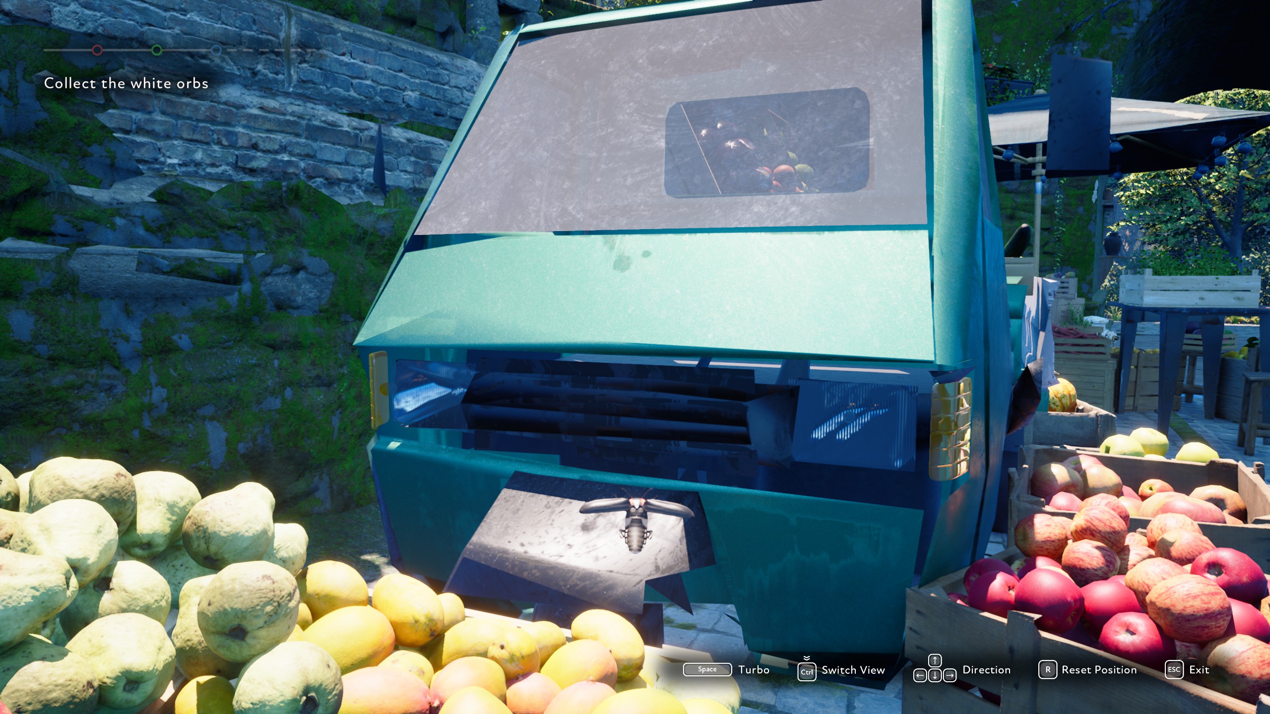

Market of Light is a free UE5 game (okay, more a showcase with minimal gameplay) that can be found on Steam. Unfortunately it has several graphical glitches on my Arc 770 16 GiB. They were there when I bought my Arc A770 last December and they are still there 11 months later with the latest official driver 4887.
Best is to view a video on Youtube that shows how it should look and then compare it to what Arc makes out of it.
https://www.youtube.com/watch?v=SV81mMDAsyo
(not my own video)
Most obvious problem is the Piaggio Ape that is parked in the market right after flying through the tunnel. All plastic and rubber parts are missing and the poor Ape looks like it was second in a fight with a truck.
Also the spring in the upper part of the market is broken and looks rather edged.
The parasols are missing metal parts.
In general the graphics looks rather overbright and washed out on Arc.

Ok, here it comes.
I also uploaded screenshots of the most broken parts.
1) The Piaggio Ape is missing all parts made from rubber or plastic
2) The spring in the middle of the market place is missing round edges. Also the mist effect is too thick on Arc
3) Parasols are missing metal parts
4) Overall the graphics are way too overbright on ARC.

I want to let you know that our debug team concluded the issue comes from the application itself. Demo was built on UE5 Early Access before integration of the 64-bit atomics extension. Degraded and corrupted graphics are expected and cannot be resolved without an engine upgrade from the engine dev.
