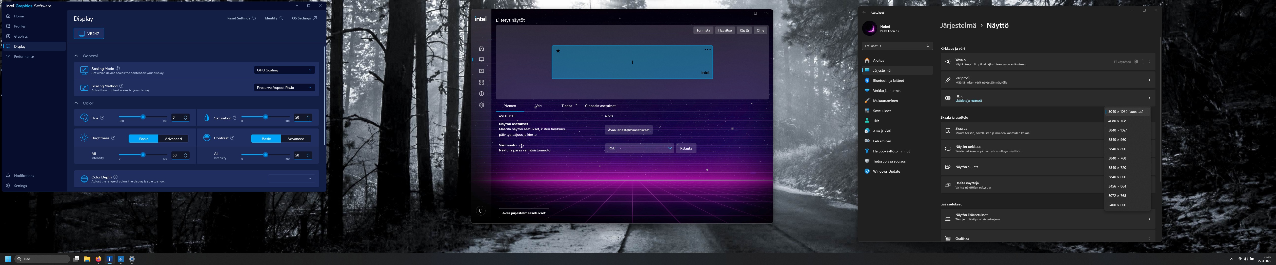

Why resolution 5760x1080 is not a available displays in combined mode even though I have three displays with native resolution is 1920x1080? now 5040x1050 without borders and the image is blurry due to incorrect screen resolution. i have ASrock b580 challenger. if I use borders with a value of 36 it is still only 5184x1050. Previous graphics cards (amd) have not had this problem.

Ok. One more message. If I connect 2 monitors, the resolution scales correctly to 3840x1080 but when I connect the third one it messes up and then the resolution is only 5040x1050. Now I also have all 3 monitors connected with the same type of cable and that didn't help either (DP-->HDMI) With the latest driver I could only connect 2 monitors together but with three monitors the combined mode didn't do anything.

1. Combine 3 displays into combined desktop in IGCC.
2. Go to Settings > System > Display
3. Check what is the current resolution for the combined display.
4. Try to change Scale to 125% or 100%
I hope to hear from you soon.
Jed G.
