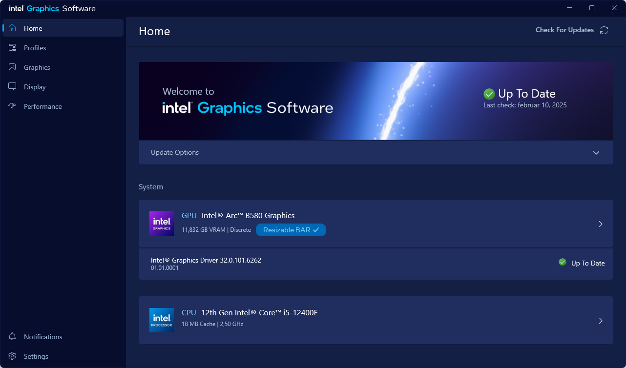

I have now successfully done a Clean Installation of the Intel Arc Graphic Driver on this PC, by selecting Clean Installation (that was a bit hidden in the installation setup menu) of the Intel Arc Graphic Driver Setup file that I downloaded. This is the very same Graphic Driver that I used before, Intel Graphic Driver 32.0.101.6262 for Windows 11.

Hello ReL0aDed,
Thank you for the update that you have already done a clean installation. So, for me to replicate this concern, kindly provide a screenshot of the settings for me to have a better replication.

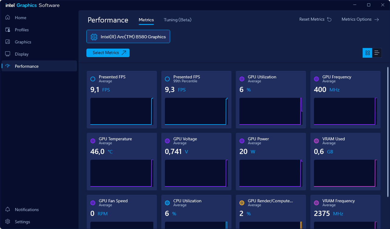

Here you go.
I did previously have a custom profile in the Intel Graphic Software for THPS4, but I deleted that now before trying out THPS4 once more (still the same framerate issues), because it served no real purpose at all (I was not able to fix the framerate with custom settings for this game, like with the Unreal Engine 1 games).
