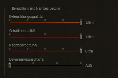

These Artifacts only happen in the garage, nothing wrong in battle.
First used the driver gfx_win_101.6325_101.6252 (clean install with DDU), then gfx_win_101.6325_101.6253 when it was launched the same day (Friday).
Both versions have this issue. The intrgrated UHD 770 Grafiks work fine tho.
I then checked the in game settings and found out that by turning down 'Lighting quality' and turning off 'Post-prozessing' the Flickering stopped.

Hello Earl,
I downloaded the Wargaming . net Game Center from the website and installed WoT from there.
My previous system (I5-7600K + GTX1070 + WIN10 Pro) had no problem. I used the 1070 with my curred system (see above) untill 20.12. (Fr.), also without problems, then switch to the B580.
I first install the driver gfx_win_101.6325_101.6252, after using DDU to uninstall the Nvidia drivers, then launched WoT and had the problem seen in the video. Version 101.6253 didn't fix it. Do you want me to install 101.6252 again? Removing the curred driver with DDU first?
