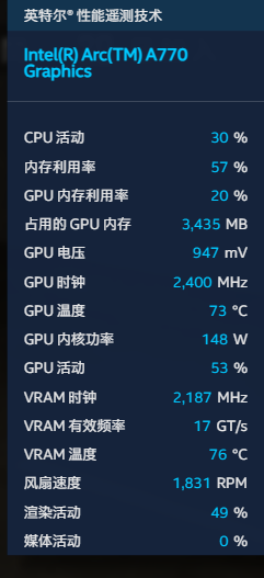

dx11下占用70%。dx12锁120帧数。

A750 plays Jedi Survival and is unable to occupy and run in directx11 mode. It locks 120 frames in directx12 mode.

Hello Tobesul,
We were working on the investigation and we are still working on performance improvements for PUBG on DX11 so please expect new driver updates soon. We recommend keeping drivers up to date.
For the 120 FPS cap you should check with the game settings for Vsync/Adaptive sync configuration since the game worked fine for us., check with the game developer for additional support, since this is coming from the game itself.
Let me know if you have further questions.
