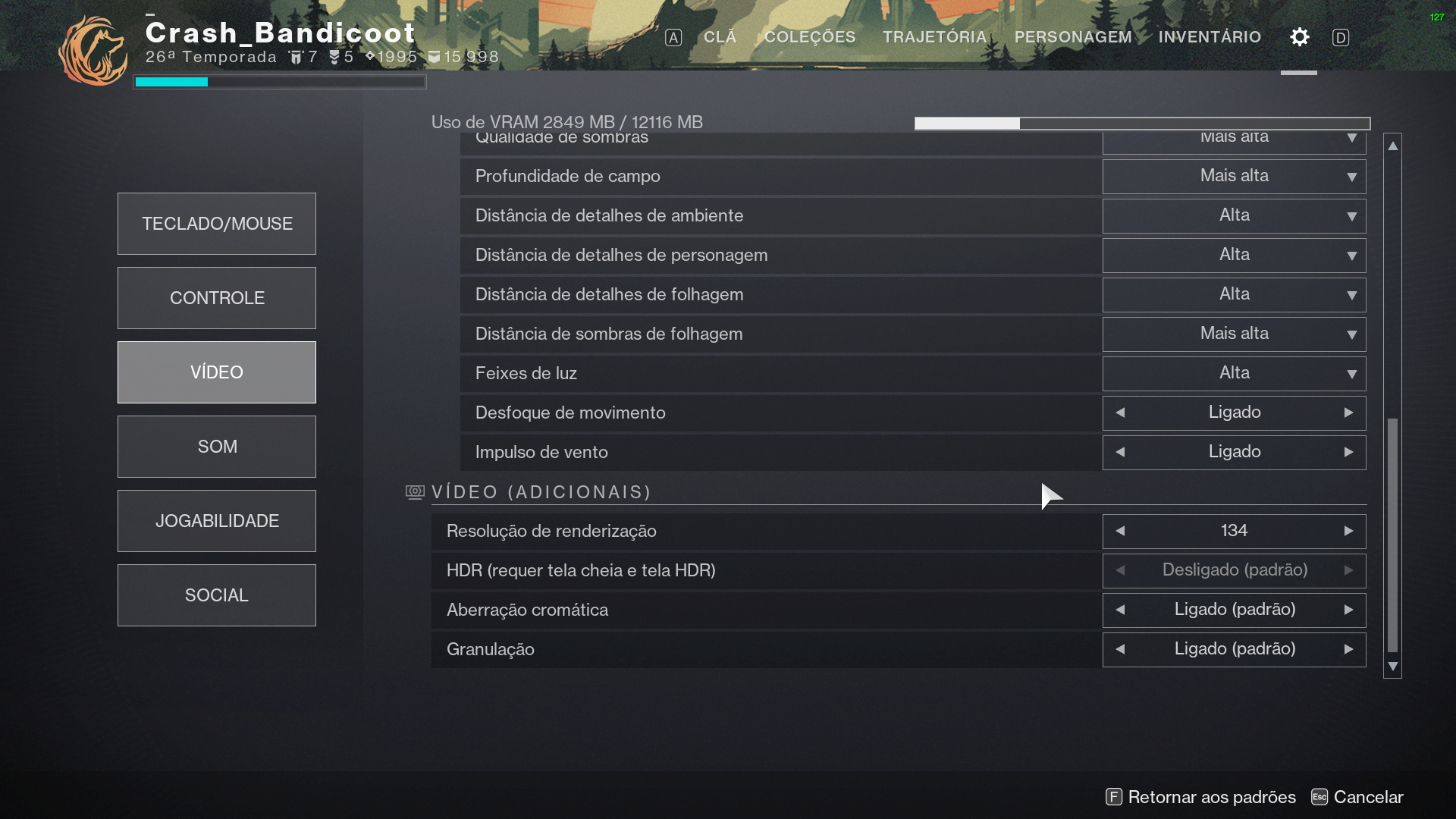

I'm having performance issues in Destiny 2, it's as if the video card doesn't understand that it's a game because it's in low usage while the game is open in conjunction with the usage.

- Can you share the screenshot of the game's Graphics settings?

1. I can't send the video because of its size
2. I've attached the game settings

Upon checking the SSU, you are using Graphics driver 32.0.101.6876
The latest that we have is version 32.0.101.6877
Kindly install the latest version using DDU method. Please refer to the links below for the steps and where to download the latest driver:
https://www.intel.com/content/www/us/en/support/articles/000091878/graphics.html
https://www.intel.com/content/www/us/en/download/785597/intel-arc-iris-xe-graphics-windows.html
If you are still having the same issue, please help provide the following details for further investigation.
- Please help generate a new SSU showing the latest driver
- Provide a CapframeX capture during a 3 to 5 minute gameplay.
- Submit the kernel dump from your system.
